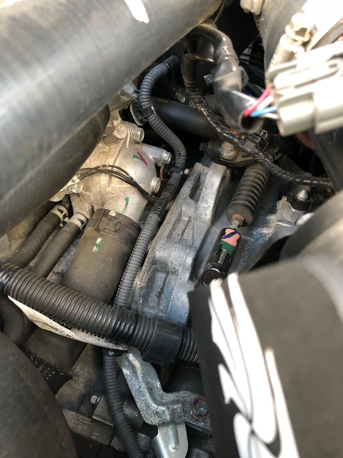

Picture of Missing Bolt

Did they change something in the later years? Mine looks different then yours

Originally Posted by ipointatthesky
UPDATE 7/15/18.
i got to take a look again today under the hood and found something possibly alarming. I can't believe all the mechanics missed this. My personal performance shopped missed it and also the dealership after 5 days of having my car. Reasons why it is always best to put it your own work at least because it is impossible for someone to catch everything not even to mention care enough to try. As you can see... this is pretty straightforward. Unless everyone tells me it is not necessary.. it looks pretty damn necessary.
Missing a bolt... Please advice as to what it's attached to, consequences, and part number?
ed this. Please see pics for reference. Can you tell me what it is and how to get the replacement.
That hole is unplugged from the factory. Nothing is missing.
You are using premium fuel right?
Check that all vacuum hoses are in good condition.
The reverse engagement delay is something that sometimes happens on the SST. This is my second ralliart and both did the same.

Assuming my picture is similar to yours, the bolt is only holding the mount for the wiring harness? I'm not sure if thats what I'm looking at.
Thanks for the reply, but you are sure it comes unplugged by default? Why even have the hole? It looks important too. What is it attached to?I use 93 or 94 only. I had Mitsu dealership did a vacuum leak test and checked all the sensors except for throttle position sensors and fuel pressure sensors. Don't know if that could affect it but I am thinking it may. The car runs beautifully once on 3rd gear and above. Still sees the RPM go up not consistently but much less and I can't really feel it. I consistently get to around peak boost based on Cobb Stage 1 map.
Mine is like that too. So I wouldn't worry about it. That is a question that a mitsu engineer involved in the design of the ralliart can answer. Maybe on the EVO is used to secure the intake or something else that we don't have.
