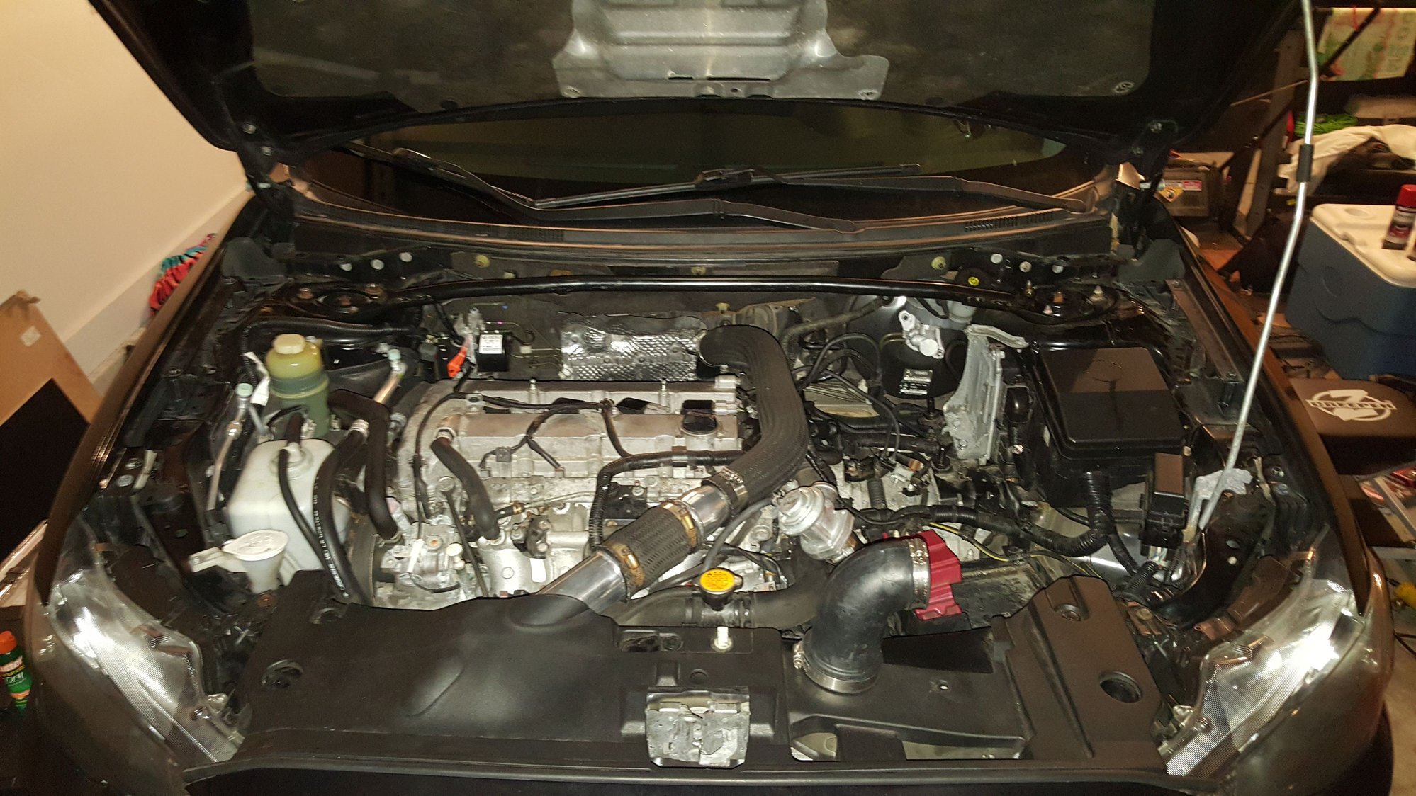

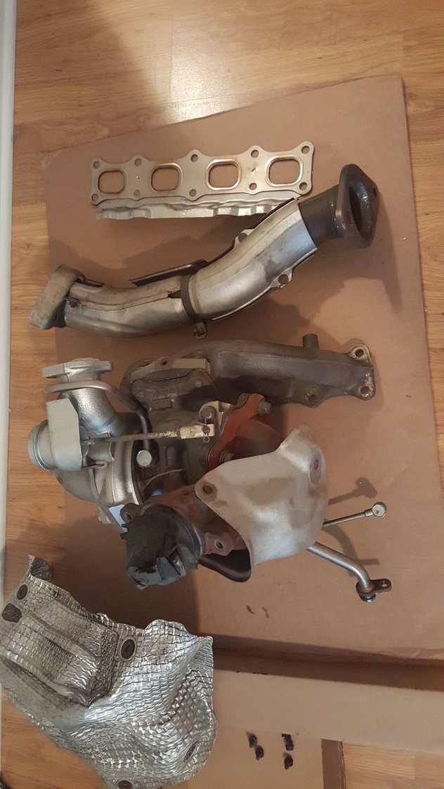

Finished up with 90% of the X swap just need to fabricate something to use the ralliart AEM airbox. Thanks to opjohnsmith for the parts.
What tune are you running with this swap ?
Are you using ralliart or Evo plugs and MAF?
90% completed 12hrs & some scars.
99% just need to fabricate a connector to mount the ralliart intake correctly.

Well I ordered an Evo X MAF and plugs. Chet is working on my E-tune. Excited to see what the car can do once it's dialed in.

With the AEM I am just using the piping and I cut the accordion stock hose to mate the turbo outlet and the intake.

I'm using the AEM ralliart box. I removed the stock mounting bracket and got it in temporarily. Just a piece of modified hosing to make the mate between the two pipes. I'm going to have a pipe fabricated so I can keep the AEM and big battery.

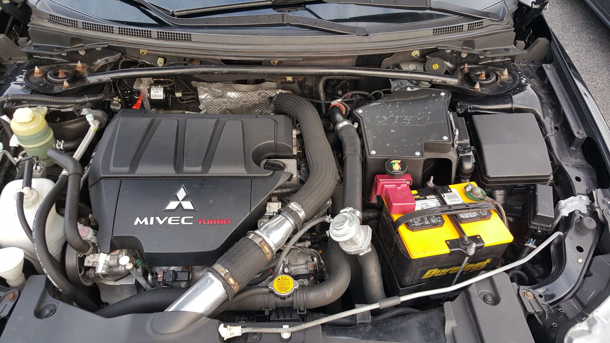

Apparently the car was already running Evo plugs, I already ordered an Evo X MaF and Cobb ebcs hopefully by the weekend ill have them installed .
