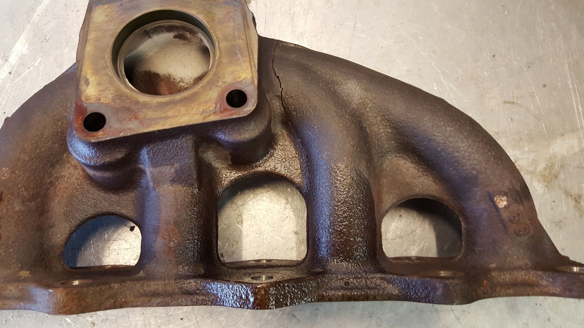

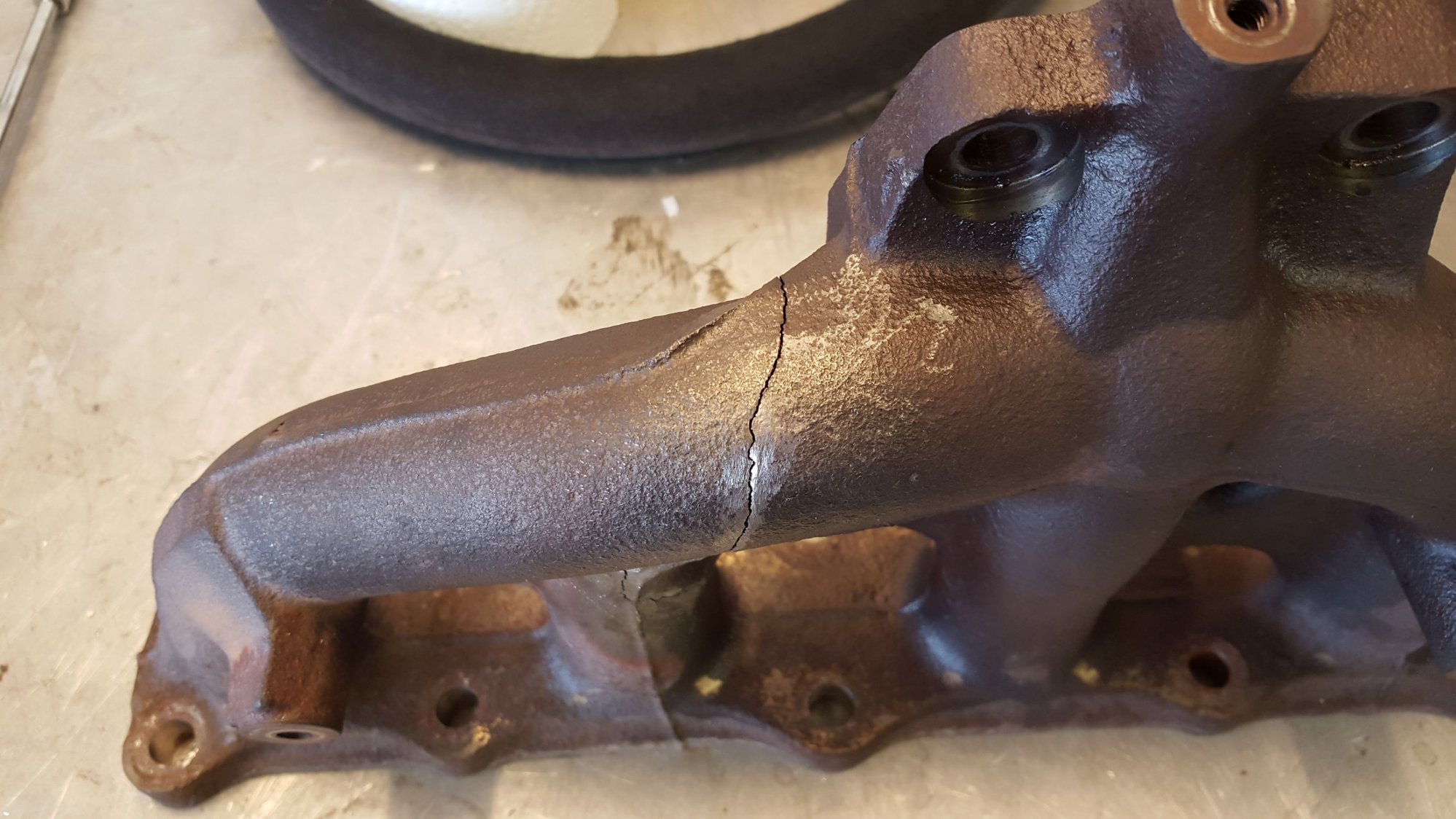

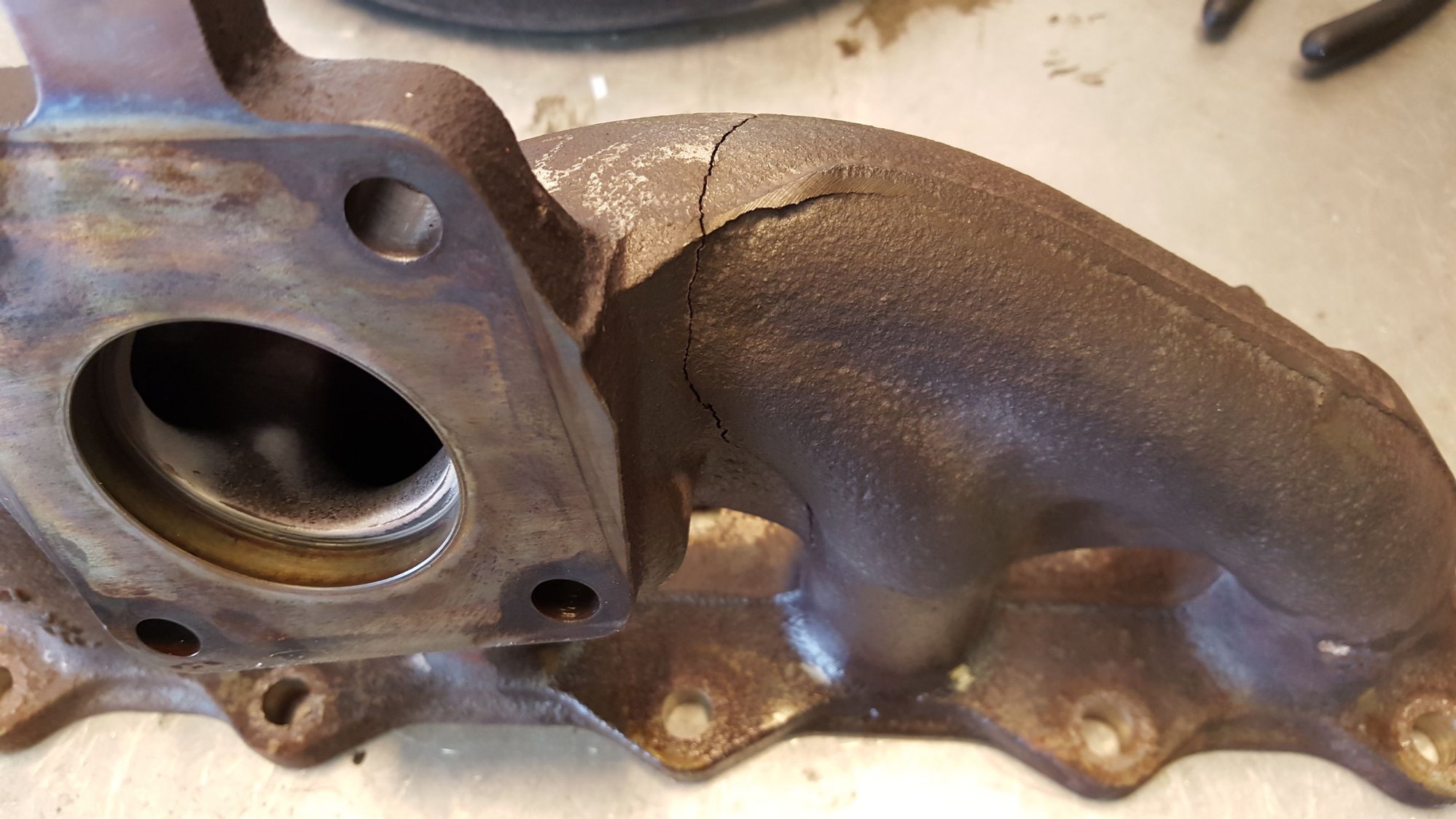

Just bought an 09 RA, knew it had an exhaust leak (you could hear it) but it didn't worry me much. I drove it around the past month and decided to finger out where the leak was coming from.
Pulled the heat shield and the manifold is cracked. All the way around. Apparently this is a problem with these cars.
Local dealer wants $680 for it, found several sites online selling them for $480. Even at $500 (after shipping), that's some serious coin! I'm hoping anyone knows of an aftermarket brand (I haven't been able to find one), or if anyone has one lying around that they'd be willing to part with.
Also, if I buy a new one, is there anything I can do to prevent it from happening again? I heard you can ceramic coat it, anyone have experience with that?
Thanks in advance.

My advice is to let the car warm up a little before driving it(even in summer). That's what I've always done, and I have a 09 Ralliart with no manifold cracking problems. Is that the reason why I haven't had any problems, or are the two issues not at all related? I honestly don't know for sure the answer to that question, but that's my method I've been using and I'm sticking to it.....

Thanks for your input, yes I looked around and it seems like everyone either got a replacement from someone on a forum or bought a new one. I was hoping to get one used off someone who did an EVO swap, or another turbo manifold swap.
Considered doing the EVO swap, but being that this is my daily driver, and that it's in CA where the smog laws are draconian (BTW, I heard they're doing SMOG CHECKPOINTS now.... wtf), I'd rather keep it stock. I know once I do a mod like that I'll get carried away.... Which is why I can no longer drive my Tundra.
Couldn't find anything on the ceramic coating though. But slee, you're right about warming it up. I always do that with my vehicles, even though it doesn't get colder than 40° or so here, I always give it a minute to warm up. But who knows how the last 110k miles have been on the car. I knew it needed some work, it's why I got a good deal on it. Even if I have to buy a new manifold it was still a good deal at $8500.

It seems fairly common on both the RA and EVO X cars.
I just upgraded to the EVO X turbo kit because it was overall cheaper than replacing with another stock one. Looks, sounds and smells stock. You can run the stock exhaust on it.
I did not want to crack another stock RA one so I upgrade with someones very fresh stock EVO X one. They upgraded their turbo at 5k miles.
Your are the 5th case that I have seen on the forums that had a crack at the same exact spot.

This is a common issue with the factory Evo X and RA manifolds. I recommend grabbing a tubular manifold and Evo X turbocharger instead of putting on another RA manifold that's prone to crack. This issue has plagued Mitsubishi since the early 1G/2G eclipses.

Technically speaking if you need to remain stock, you can have a shop reinforce the manifold when you find another one. It just depends on how much money you are willing to spend. I'd say go with an Evo X swap if you can. That's what I plan on doing.
