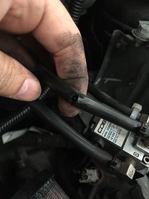

Hey Guys-
So the story is my car has neverreally ran the best. I always assumed that maybe the weather wasaffecting my cars performance. At one point I noticed via the Cobb APthat I was not making full boost. According to the Stage 3tuning notes from Cobb I should have been making Peak 21.5 PSI thentapering done to 17 Psi. Now I didn't really know what the issuewas. I assumed it was the tune.
So eventually installed anactual Boost gauge and A/F ratio gauge. It still seem to be peakingat 19-20 Psi. The car felt sluggish and it just wasn't spooling asquick anymore. So tonight I decided to try finding some sort ofboost leak. Well I found within a few minutes of looking. It was thePort 3 of the vacuum line on the EBCS.
It was cut pretty cleanly, somaybe I have snagged it by accident. Who knows. My concern is howdoes this directly affect the turbo? Any feed back would be great.

Here is what the line looked like

Depending on which line that is would effect it differently. Replace that line and you should be good to go

Thanks, I had enough slack to cut the rest off and reconnect. I took it out and it seemed to be back to normal. FYI this cable connected to the elbow of the turbo.

Running better now. AFR's look good. Thanks.
