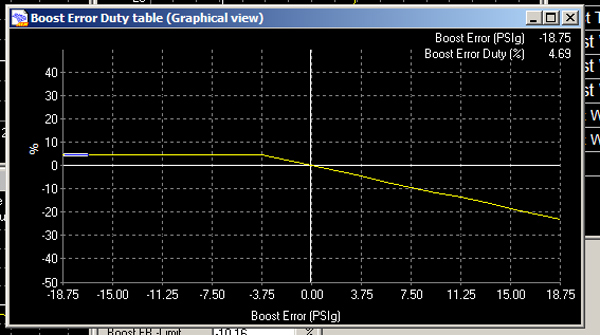

Take a screen shot of your current FB graph. It should be gradual. Also what boost solenoid are you using.

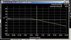

Start out with a very gradual graph.

Originally Posted by DWAIST
in the pic above is it using "boost target comp" instead of "boost error duty" to regulate boost? in the AEM instructions they recomend using "boost error duty" which one is better?
If you bought one that says AEM you can use hostile's one.. If you bought a MAC solenode then use mine. The MAC let more boost through. That why you need to start with a lower correction. Or you will have surge.
