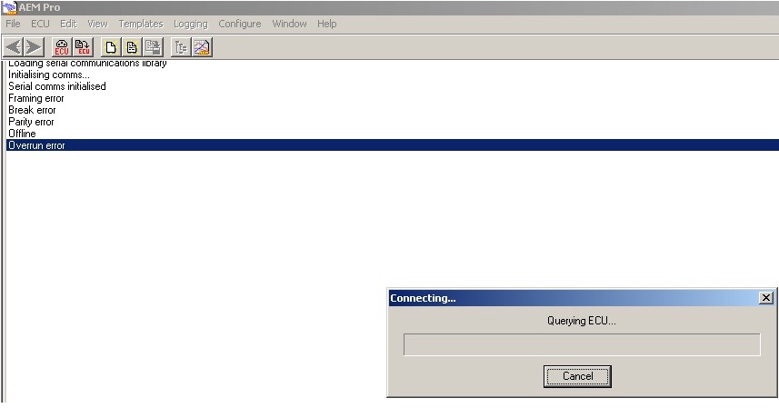

yesterday my electrician guy toll me than was the crank sensor but when i pull it up i tested and it was ok, i cant get into the aem ems as well check what happen when i try to connected

sounds like the ecu.
is there anyone local that is willing to let you borrow an ecu to try & start your car with your cal file?
heck, it would go good to see if you can hook up to the ecu!

I had this happen to me once before. I had to unhook the battery, unhook the ems, let it sit for like 1 hour, and reboot the laptop.
After all that plug the ems back in, connect the battery, put car into acc, turn laptop on, once you are in windows, plug in the serial/usb cable. Then try to connect.
If that does not help then I would give AEM a call and see what they have to say about it.
Worst case you will need to mail them your ECU for repair.
