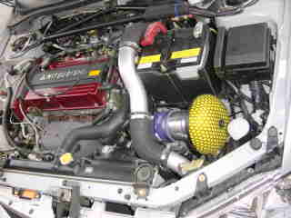

Can you post a pic of the engine bay.

here is a picture...

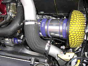

the intake
