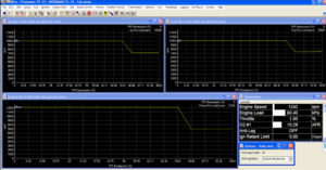

See an example! With theese settings can you describe what will happen when we shift at 8000rpm?
Can I shift WOT?
Will I have any kind of antilag effect? (keep boost)
Can I shift WOT?
I think that theese settings that I posted is only NLTS!
Because from 7500 there is fuel cut.
So even if I retard timing I will not have antilag "band" effect so no "boost keep".
If someone can suggest me settings for antilag but also to keep boost I will appreciat to tell me
