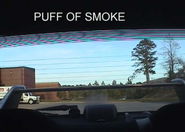

OK, my car has the following:
3" turbo back exhaust w/test pipe
HKS RS intake
Walbro pump
RC 660 injectors
HKS 264/264 cams
HKS cam gears
AEM ems (in process of tuning...)
I'm monitoring the boost and EGTs with Greddy electronic gauges
I've got an AEM wide band controller & gauge in the way and a Greddy IC waiting to be installed.
The problem?? well, I know that it's good to be safe so my car runs rich.... The question is how rich should it run? look at these pictures of the puff of smoke during acceleration (hard to get those pictures..) and the "fart burns in the parking lot behind my car... Nobody else has those in the parking lot and it appeared within 4 weeks of driving the car as modded. And that's considering that I did not even drive the car for nearly 2 weeks out of that time
Does anybody else running the AEM ems have these symptoms? Can this be "cured"?

Old Mar 28, 2004 | 06:39 AM
Evo Ate's Avatar
iTrader: (22)
Posts: 187
From: Apex, NC
Are you using the wideband O2 sensor, MAS delete, Map sensor, EGT etc.... give some more details. My car runs great with no smoke at all, only a little residue in the actual opening, it did that with stock though. It was tuned by Eurospeed in Cary, NC.
Old Mar 28, 2004 | 01:11 PM
silverEVO8's Avatar
Posts: 2,659
From: Utopia
I don't have the MAS, the car was tuned with the wide band O2 sensor but i don't have my wide band O2 controller and gauge yet . According to Boost Solutions they are on back order... Jason from Eurospeed told me they have them in stock. I'm talking with George at Boost Solutions about whether to wait or just order one from Eurospeed.... So far my car is been in the shop twice for tuning and stuff. The first time was for the install of intake, pump, injectors, exhaust, gauges and the AEM. The second time was for the cams, cam gears and more tuning. I'm not too excited with the level of tune of my car yet. I don't know what the wide band O2 sensor would say since i don't have one, but I think that given the evidence of smoke and soot I believe the car is running too rich at some point or points where it could be a lot leaner without risk. Also, my last fillup calculated my fuel use at around 16.4 mpg..... That kind of sucks I think. seems like with a proper tune and not abusing the loud pedal I should be getting around 19-20 mpg which was my mileage when it was stock.... Of course, when you are making all kinds of power (I don't know how much I make yet) you are gonna use lots of fuel. However, it would seem that in highway cruising or commuting I should get decent gas mileage......

Posts: 45
When the dyno day comes we will see, I wish George would be up there as well but he said he is going to Hot Import nights, Good customer support there. Anyway I bet your cars power running that rich is LESS then stock. We will see, there are going to be some GOOD tuners there so we can get it worked out. Looks like 8:1 or worse to me, ****ty MPG plus no power = poor tune. I am not here to slam George but he should take care of you and so far he has not.

From: Apex, NC
My mods are similar to silver's less the cams and added fuel items, but my mileage is good around 25mpg. It seems as if his car is running excessively rich, and burning fuel heavily. The dyno with wideband will tell....good luck.

From: NC
keep in mind that if you have a cat a wideband in the tail pipe wont read exactly correct, you need the sensor before the cat. the wideband after the cat will read leaner than it really is. that could be why you're car "seems" "ok" on the dyno but dosnt drive ok.
thats why road tuning with proper equipment is esential to a well tuned car.
chris's car (evo ate) is running in the upper 11:1 afr at wot under boost and still gets good economy and dosnt blow plumes of black smoke.
The car was tuned with a test pipe
The car has not been dyno tuned so far, only road tuned .... The tune was done with a wide band O2 sensor......
How's Evo Ate's car tuned? is the fuel map boost compensated?
yep.. i tuned it. i do everything with the ems boost comp'd. we did the inital tune on the street, then we went down to Knowledge performance near atlanta to do some fine tuning and see what the evo liked. for some reason the car ran richer down there than it did up here so we had to do a little more road tuning to straighten it out.
Old Mar 29, 2004 | 08:18 AM
silverEVO8's Avatar
Posts: 2,659
From: Utopia
So you ended up leaning it a bit more in the final tune? My guess is that my car is running either too rich at idle and at cold start (or warm start) or perhaps I have some injector issues.... George has my car again and he's going to fine tune it. I expect that it'll be sorted out soon..... One of the issues that I'm having is that the mods are happening one at the time. For instance, the first go around did not include the cams and cam gears. Now I'm still without the Greddy IC and the wide band controller/gauge. The car will probably need tweaking after each mod is done and I'll have these issues until it's all done I really don't see dyno tuning it until all the mods are done.....

From: NC
running to rich at idle will cause buildup that will get blasted out soon as you hit the gas. what afr are you idleing at? most evo's i have done like about 14:1 and about 1000 rpms to be happiest. what injectors do you have?
I don't know what A/Fs I'm running, I don't have the A/F gauge yet... My idle fluctuates a good bit but it's supposed to be set at 1000. My injectors are RC 660's and I'm running them with a Perrin fuel rail.

ill see about making it down there... ill talk to the guys there and see about some ems tuning. we have a few customers in GA that have traveled to our shop to get the ems installed and would probably want to dyno....
do you know if the battery offset is set properly for those injectors?
