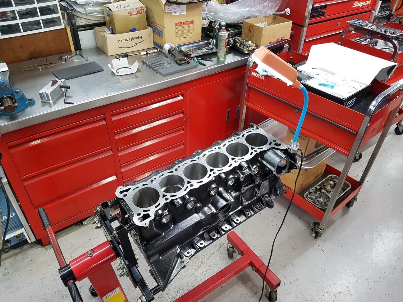

Found a few more old pics from this build. The brand new from Nissan OEM RB26 Block used for the 2.75L Tomei stroker.
