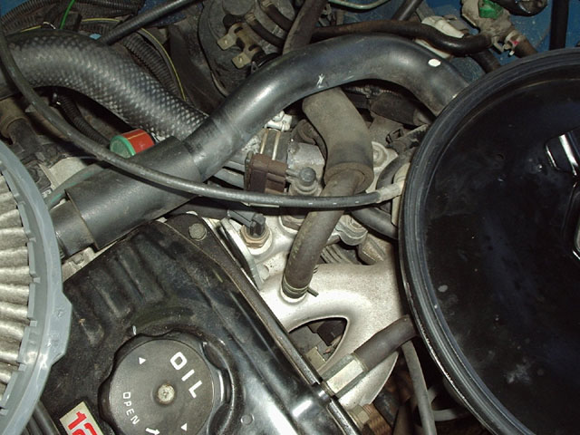

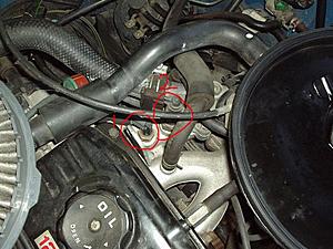

hey yah i had the same probem, first i thought its the plug cables, then the carbi, then the fuel. Nup its your thermometer thats on your intake manifold (the pipes straight under the carbi). You should see two spark plug like thingies on the intake manifold with cables or tubes going to them. GET THEM REPLACED! I got fairly new ones from a wrecker engine (never used apparently) for 40 bucks, swapped them with mine and whoala problem fixed.

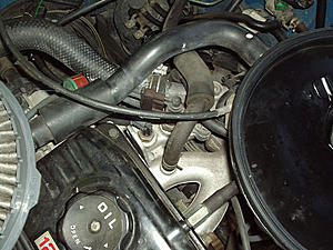

hmm well I'm not sure what I'm looking for... is it the screw type things in this pic?

yep here:
