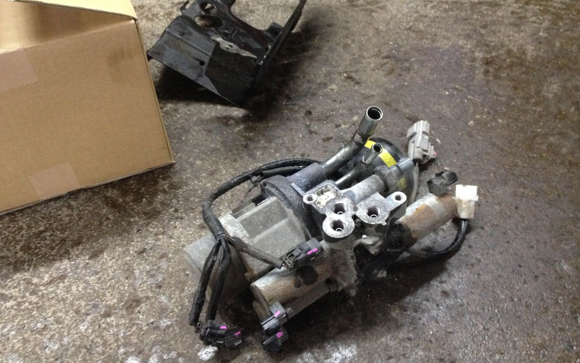

By the way, my ACD/AYC pump was recently down. So it was replaced, thank Mitsubishi!!!
