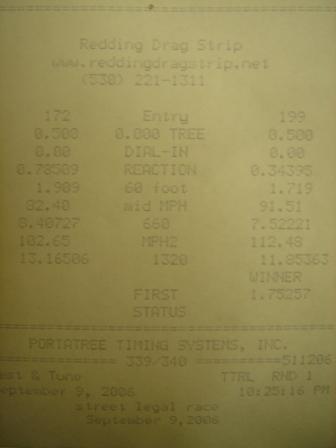

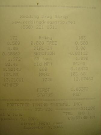

Well, I went to my local 1/4 mile tonight. Took the IX out for the first time. There was a nice turn out, but not many imports, mostly older american cars.
Heres the info...
The place
Redding drag strip - Elevation 490'
Temps
8pm - 73*
11pm - 67*
Humidity
8pm - 44%
11pm - 57%
The car
06 IX GSR (bought feb. 06)
HKS panel filter
WORKS 3" TBE
Boost controlled by ECUFlash & stock boost solenoid
Runs 1-3 - 21/20 tapering to 17/16
Run 4 - 22/21 tapering to 17
Stationary Limiter set to 5750
1/4 tank of 91 Octane
Removed Spare & Tools (-37lbs.)
Installed Sub & Amp (+57lbs.)
-------------RUN1----RUN2----RUN3----RUN4
Reaction---0.85-----0.81-----0.60-----0.78
60ft---------2.32-----1.95-----1.97-----1.90
1/8----------9.05-----8.57-----8.52-----8.40
1/8 MPH--81.11---81.01----83.46---82.40
1/4--------13.80---13.33----13.21---13.16
1/4 MPH-103.93--104.39--103.08--102.16
When I upped the boost by 1psi, as noted above, the car seemed weaker (according to MPH), but it was my best E.T.
I already know my launch is pretty bad, so flame away.
EDIT- added slips, I am car 172.
