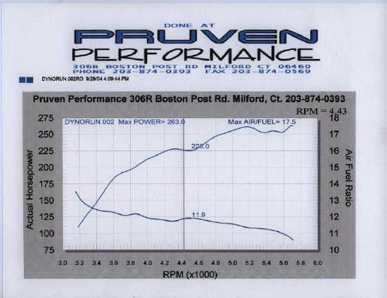

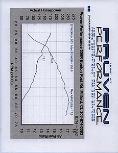

Here is his base line - boost erratic
Note the lean a/f reading on the HKS RS KIt without any tuning - stock ecu settings
Attached Thumbnails Tuning with Dyno Flash - case study #2 - ctevo-ctevo1.jpg

We decided to try and adjust the boost controller and wastegate to even out the erratic boost - with not good results - boost jumping all about - not good
The decision was made to step up to the much better working and less expensive Hallman Pro boost controller. I am NOT a big fan of the Greddy Pro Fed B II - it works OK on some cars and really bad on some others - in this case the problems may have been related to some bad mechanical work from the dealership - rather than waste time to trouble shoot the problem and get it working we decided to just go for the better boost controller on the next pull
Attached Thumbnails Tuning with Dyno Flash - case study #2 - ctevo-ctevo22.jpg

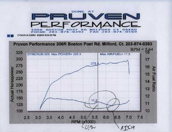

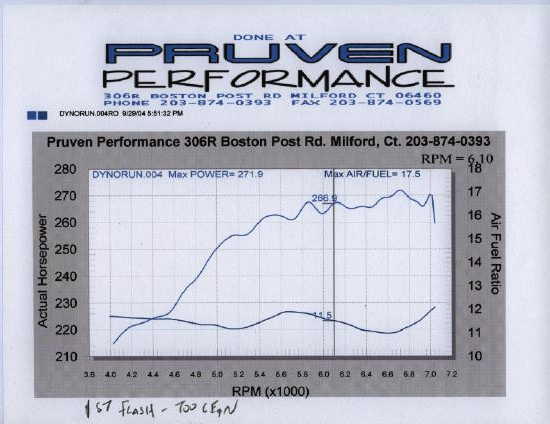

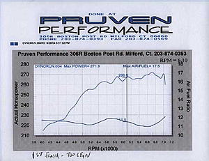

Here is the first pull with the base Dyno Flash installed - it ran way too lean and caused knock - time to make the mixture richer
Attached Thumbnails Tuning with Dyno Flash - case study #2 - ctevo-ctevo3.jpg

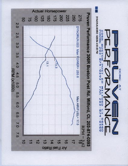

We took out some fuel and adjusted the timing to avoid knock activity
Things are starting to look better - the curve is a little rough and uneven
Attached Thumbnails Tuning with Dyno Flash - case study #2 - ctevo-ctevo4.jpg

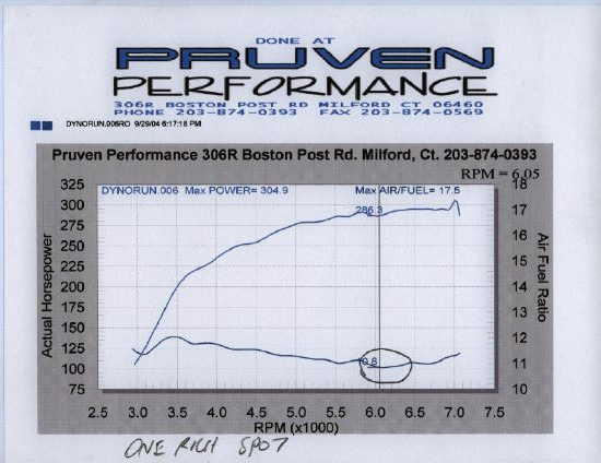

We are getting closer - its starting to take shape and pick up power as we are tailoring the fuel and timing curves
Now we are left with one small spot slightly rich - almost done
Attached Thumbnails Tuning with Dyno Flash - case study #2 - ctevo-ctevo5.jpg

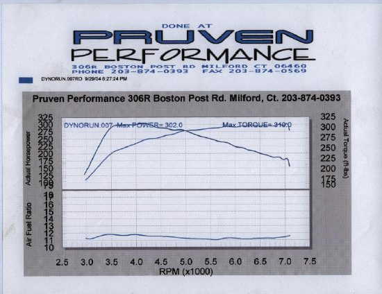

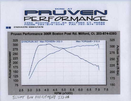

Here is the final result - note the bov was leaking slightly and needed further adjustment - hence the slight bounce upon spool up
This is a great result considering that he still has his stock cat and it was on 93 octane pump gas at 21 psi
With a high flow cat or test pipe additional gains would be in order
As usual - a real pleasure to drive on the road - very smooth and fast
Yes - it took us a long time to do it - but the results are worth it - and as always the customer pays a flat fee with all dyno time and tuning included no matter how long it takes to get a perfect tune.
Attached Thumbnails Tuning with Dyno Flash - case study #2 - ctevo-ctevo6.jpg

Final sheet
Old Sep 29, 2004 | 04:37 PM
DynoFlash's Avatar
iTrader: (91)
Posts: 16,850
From: 2003 Evo VIII - Silver
Here is the final sheet with the a/f included - flat line a/f makes for a smooth machine
Attached Thumbnails Tuning with Dyno Flash - case study #2 - ctevo-ctevo7.jpg
