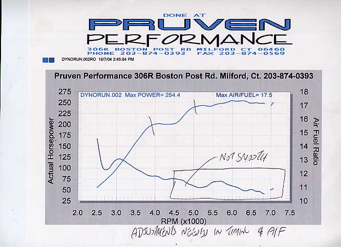

Here is an example of a car that had some issues which took some time to identify.

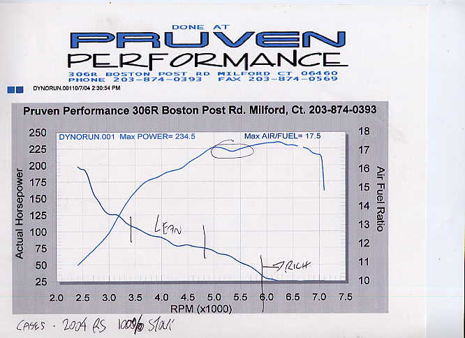

This car was a 3,000 mile 2004 Evo RS with zero miles
We can see on its base line run a typical stock evo.
In retrospect our little dip at 5200 rpms should have set off some warning bells in my head. At the time I assumed that the gas was suspect.

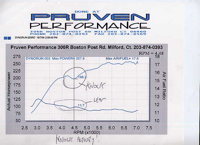

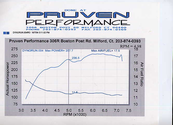

Here we have the Dyno Flash base map installed and picking up power right away
However the a/f curve and power band is not smooth
There is a rather large dip at 4500
Its the same dip we used to see at 5200 in the base line - more on this later
I set about to smooth out the a/f ratio and tweak the timing and keep an eye on our little dip

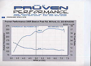

Richer still - getting smoother and closer to my target a/f slowly
Still that dip
I am starting to wonder about our stock BOV
Time to hook up a boost gauge on the car
Still that dip

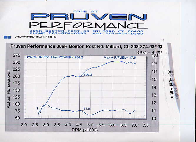

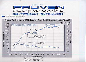

The curve is getting smoother
But I dont like what the boost is doing
4500 has something going on
The a/f is nice and flat and we have reached 260 to the wheels which is a decent number on a stock car
Time to install a MR BOV for diagnostic purposes !

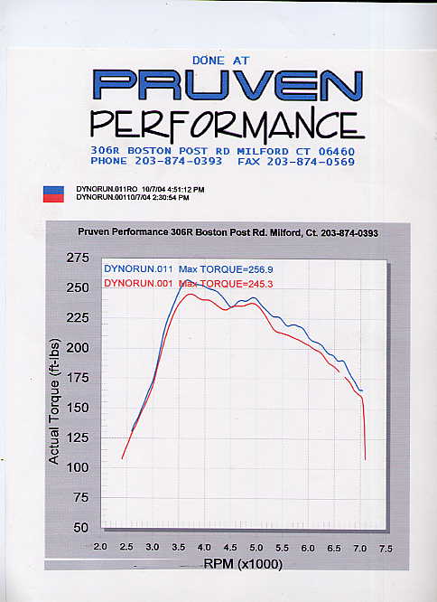

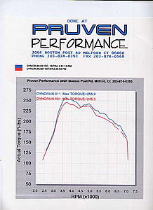

By run 11 we can see that I have been getting no where with tracking down boost issues
The timing curve is perfect
Zero knock
Everything is good
But still we see the same pattern in the trq curve - a dip at about 4500
The plugs look good - gap is good and they are reading well
However - I take a chance and swap out the plugs for a new set
Zero knock
Everything is good

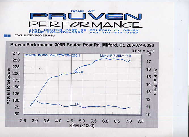

BAMM. It was a plug !
As soon as I put in a fresh set of plugs the problem was solved - totally smooth trq curve !

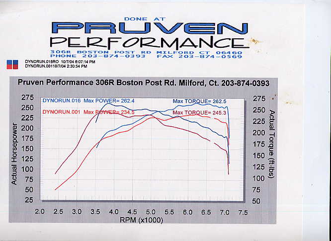

A few fine adjustments later and here is our final sheet
A smoother curve and a lot more power and all with a nice conservative 11.1 /1 a/f ratio
Driving this RS was simply a dream - a wonderful machine and now its smooth as silk !
I should have figured it was plugs right away - BUT in these cases you have to go through a series of diagnostic steps to track down what is causing the problem . This is what keeps my job interesting day after day and what really makes it a challenge for me.
If you look at the time stamps on this sheet you'll see this tune took me almost 4 hours on the dyno to get it done. Sometimes you can't get a really good job done quickly and you have to take longer to get a decent result.
Situations like this is where our one price policy really pays off for our customers.
