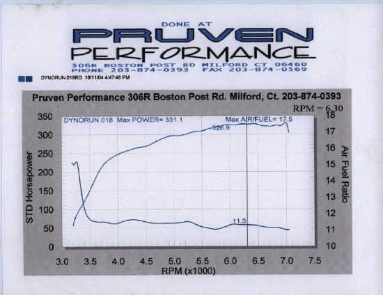

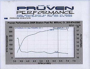

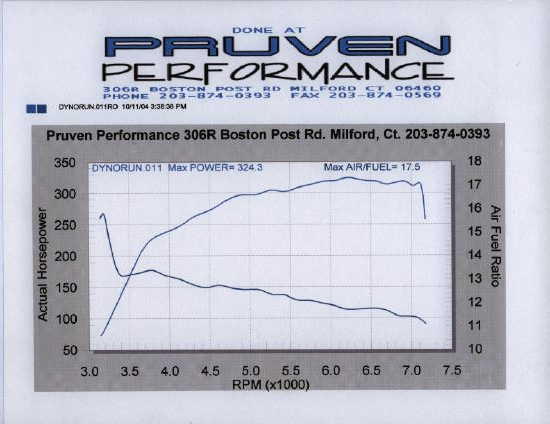

We were pleased to welcome back member Subievolved with his pal Spec C today to Pruven to test the flash he had recieved from another tuner
Here is his base run
I found this tune to be very lean and there was evident knock activity and pulling of timing. The areas of evident knock activity where 5500 and 6700 rpms as evidenced from my pre-dyno road scan of the OBD-II data and by looking at the dyno chart.
IMHO - super lean and retarded timing = high egts and dangerous conditions which add up to no added power
This tune will attempt to verify that we can make the same - or even more tq and whp with a much richer and safer tune which pulls much smoother and has a nicer dyno sheet
Attached Thumbnails Dyno tuning with Dyno Flash - Case Study # 7 - Subievolved take two-subi1.jpg

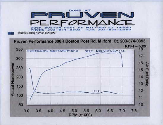

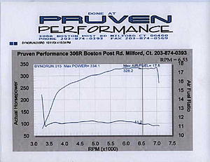

Here is the first pull with the Dyno Flash - interestingly our client discovered that he had left a vac nipple off his HKS intake which obviously seems to have thrown off our tune
Our original plan was to simply re-install the old Dyno Flash settings we had made when this gentleman was here on September 4th
Sadly it seemed that the plugging of the leak on his air intake altered the way the MAF was reading and results in the need for a totally new calibration
Attached Thumbnails Dyno tuning with Dyno Flash - Case Study # 7 - Subievolved take two-subi2.jpg

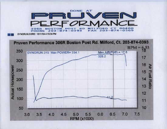

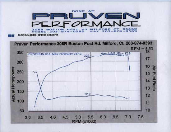

We started to lean on the tune and then we saw some oscilation with the Blitz boost controller - so we then turned down the gain on the next pass
Attached Thumbnails Dyno tuning with Dyno Flash - Case Study # 7 - Subievolved take two-subi3.jpg

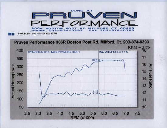

Starting to make some big power here - but too lean
We need to riched it up

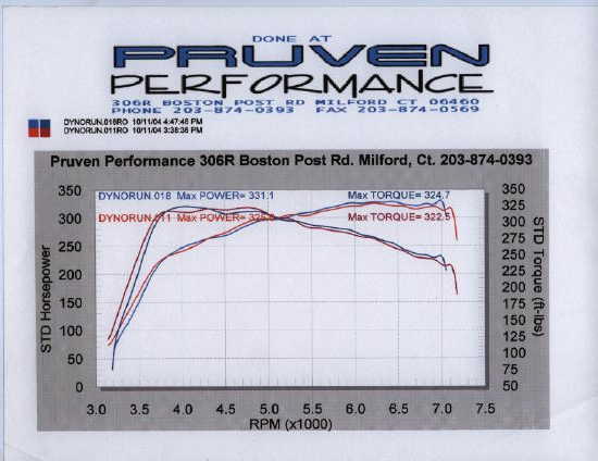

Here we are getting closer a few runs later
We are trading off max peak power for some margin of saftey and smoothness
Compare this to the super LEAN tune he rolled in with - less power and leaner
Attached Thumbnails Dyno tuning with Dyno Flash - Case Study # 7 - Subievolved take two-subi7.jpg

One tune in the 12's and rough with evident knock and pulled timing
Our tune in the low 11's with a totally smooth power and and even steady timing - we actually are making more power
Another fine job that I am proud to put my name on
