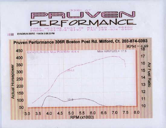

Base run
AMS GT35R
3" exchaust
272 272 HKS cams
780 cc injectors
Walbro fuel pump
Stock head and valve springs
ARP head studs and rod bolts
AVO fmic - stock upper fmic pipes
Turbo xs RFL BOV
Hallman MBC
20 psi
Attached Thumbnails Tuning with Dyno Flash - case study # 14 - AMS GT35 R-gill1.jpg

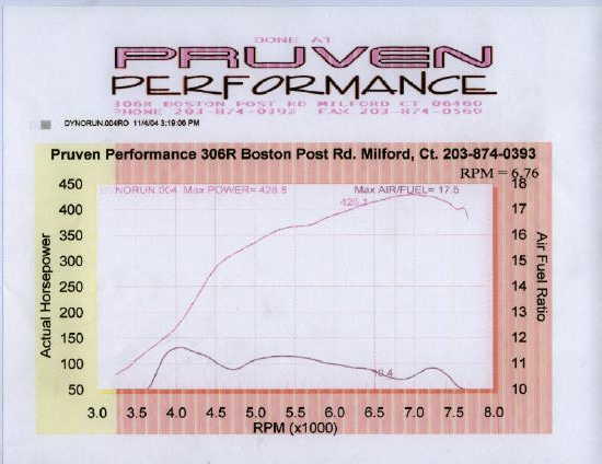

Tuning - leaning out and tweaking the ign timing a bit
Attached Thumbnails Tuning with Dyno Flash - case study # 14 - AMS GT35 R-gill2.jpg

On what octane, Al?

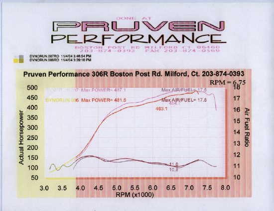

Lets turn up the boost a bit and make further adjustment of the a/f
Attached Thumbnails Tuning with Dyno Flash - case study # 14 - AMS GT35 R-gill3.jpg

Originally Posted by evotomig
On what octane, Al?
BTW man - I am very interested in these Forester STI set ups - I intend to be doing some tuning work on those shortly - I noticed this in your signature - a fine choice in 2nd cars !
This is a mix of fuel 100 octane effective

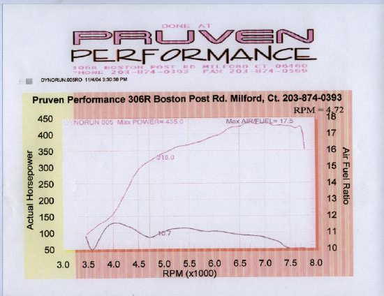

More boost - up to 25 psi now
Attached Thumbnails Tuning with Dyno Flash - case study # 14 - AMS GT35 R-gill4.jpg

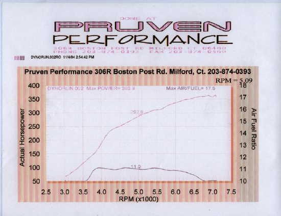

We are slowly raising up the boost to 26 psi
I have the next two runs on the same page
Attached Thumbnails Tuning with Dyno Flash - case study # 14 - AMS GT35 R-gill5.jpg

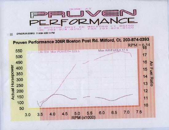

Here we are at 28 psi boost
The so called "no name" clutch either slipped on the dyno or the tires slipped - I am not sure which - but it was a pitty as we did not want to push things any further on the stock block
The Dyno Flash can make power if you have the right parts
523.5 whp - a decent reflash result
Attached Thumbnails Tuning with Dyno Flash - case study # 14 - AMS GT35 R-gillfinal.jpg

nice job Al...you think he can break the 11.00 barrier? Or should he have the bottom end built and push the boost higher?...hey i was thinking,can the flash eliminate the check engine for the aftercat o2 sensor? i think ive heard of this on other applications......Again, real nice numbers.
To go 10.99 on a stock weight evo you would need a bit more power - IMHO - probably at least 560 whp. This car will prob easily go 11.2 or 3
Buschur Racing has a nifty cel eliminator curcuit which wires right into the stock wire
