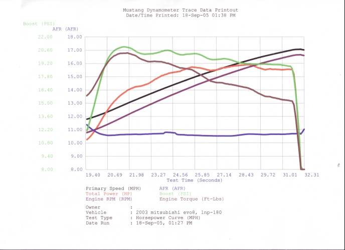

Al, I've had a mail in flash and then stepped up to a custome street tune a while back. I finally got my car dynoed today since I wasn't hitting the quarter mile times that I should be at the drag strip. I'm running a little on the rich side. Please take a look at my dyno sheet and see if you could help. Can I send you my ecu to tweak or do I need to have it retune again? I haven't installed anything on the car since the custome street tune at BR. Here are my mods.
HKS RS intake
HKS 264/272 cams
255 fuel pump
660 injectors
BR 3" turbo back with highflow cat
BR upper intercooler pipe
MBC@ 21 psi
Is my hp numbers and tq a little on the low side or are they where they should be on a Mustang dyno. Thanks

Based upon what i am seeing on Mustang dynos your power is on the low side at least 30 whp low.
The curve looks ultra smooth and knock free and the A/f is flat as a lake although a tad rich - IMPORTANT TO NOTE that the stock ecu has a very sensitive coolant temprature enrichment compensation which will make the a/f table slightly richer when the coolant temp is hot which is easy to do on a dyno without adequte air flow and cooling between runs
The boost is holding good but a little on the low side - too conservative.
I would suggest turning boost up to 21.5 psi falling to 20 flat if it will hold that mcuh at red line - that should net you half your missing power
Also - you can send in the ecu and I will make it one half point leaner across the board - that should get you the other half - I'll cover the fed ex charges and the retune is free
Not sure where you live but if you can make it back to BR next month I will retune you for free when I am there on the 13th and 14th on the Buschur Mustang Dyno

BTW what kind of MBC do you have and which BOV do you have ? The boost curve is oscilating up and down slightly like a wave and you can see the tq curve follow slightly

Ok, thanks. B/w I have the BR MBC and BR 1g BOV on his upper intercooler pipe.
Old Sep 18, 2005 | 09:34 PM
DynoFlash's Avatar
iTrader: (91)
Posts: 16,850
From: 2003 Evo VIII - Silver
A little extra boost will go a long way
Also - did you slightly "crush" the 1G BOV yet?
The way the boost curve is wavy like that I would suspect the BOV may be slightly leaking boost
