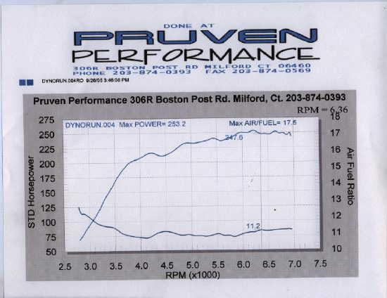

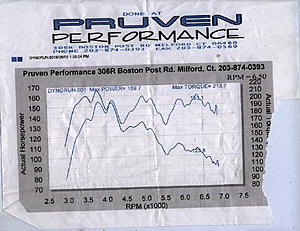

I have been saying that the K & N Typhhon sucks for a long time and yet people keep buying it
Here is is base run
I thought he must have a major problem with this weak power comming in
I ordered a boost leak test and a compression test which were both a waste of time
Attached Thumbnails Case study # 99 - Typhoon Nightmares and Solutions-typhoon1.jpg

With nothing wrong on the car mechanically it was time to try some tuning
Here is the results with the base dyno flash
Even with the boost controlling flash the boost was still falling down a lot - no doubt due to the typhoon intake
Not bad for a base flash but still less than some stock cars make
I suggested the new Forge UNOS MBC which was then intalled
Attached Thumbnails Case study # 99 - Typhoon Nightmares and Solutions-typhoon2.jpg

what the hell is that! Wow looks like the rockie mountians

Here is the final tune after a few adjustments in a/f and timing - ready to take it out for a final road tune and adjustment with the new data logging dyno flash
I was amazed with the gains !!!!!!!!!!!!!!!!! The forge unos MBC rocks - the boost is holding 20 psi at red line
21 psi peak
93 octane
Attached Thumbnails Case study # 99 - Typhoon Nightmares and Solutions-typhoon3.jpg

A few months ago in Dsport I beleive, they tested the typhoon and actually gained like 10whp from it. Now, I know you've had bad results with the K&N, but can it really be that much different from some other intakes out there? Or is there some correlation between low power cars and typhoons.

Hey, i have this typhoon intake and i lost big hp as well.. only pulled 209 AWHP, and 237 AWTQ... i just received my Hallman PRO RX MBC, and im waiting for exhaust... once i get these things done, those are the kinds of gains you can do for me with a custom flash? if so im not so upset anymore that i have the typhoon.. and ill be dealing with you...

good lord, that graph makes me want to crumple it up too!! Great recovery Al!!

that graph was completely off the wall....
