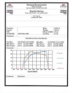

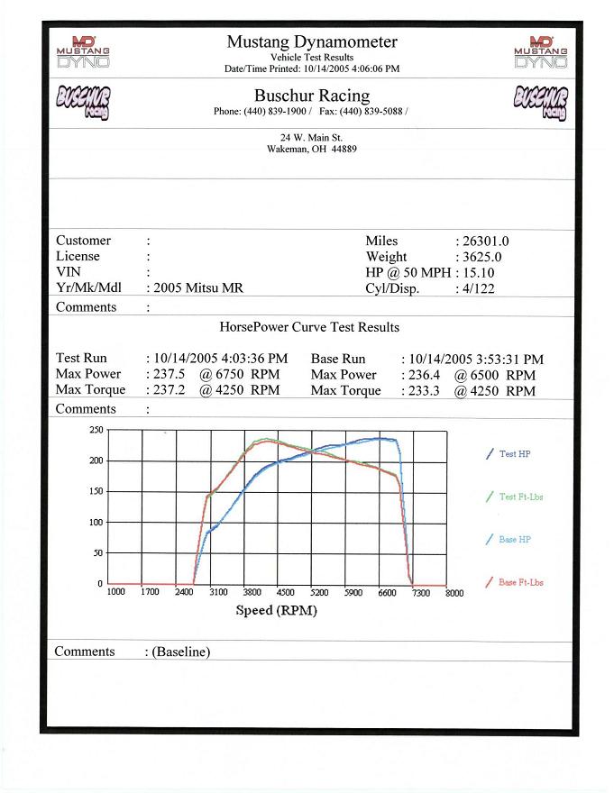

Due to some outside influnces from friends at work and a few others with evos I decided to get the mail in flash.
Due to more pestering and driving co-worker's evo, I decided to go to Buschur and get the full custom tune.
Due to kicking myself around, I decided to add a Hallman MBC, Buschur Intake and filter, and APS BOV to make the tune worth it. I was throwing around the idea of upgrading the exhaust system, but I'll have to hold off on that for a while.
Anyway, The results are attached.
(Max Power = 237.5 @ 6750; Max Torque = 237.2 @ 4250)
For the 3 mods that I have, do you guys think this is good power???
Any other MRs I can compare with???

do you have a baseline? what kind of a dyno did you use?
edit: oh mustang dyno. ha, maybe i should look at your sheet. seems about right...

Nice especially on BR dyno but you should have waited on the tune until the TB or cams

You should have just waited untill you got an exhaust before the tune.

To put your numbers in perspective, that would equal about 275 on a dyno jet dyno.

bTW - I wonder why people are so fixated with dyno numbers?
By changing some of the correction factors in the mustang dyno it can be manipulated to read out any numbers you want.
A dyno is properly used as a tuning tool to run the car and sample data so that changes can be made.
What is important is the shape of the curve which in this case is nearly ideal and the A - B comparision before and after tuning.Inst how the car "feels" and runs more imporant than a few whp one way or the other?
What use is a dyno sheet figure that quickly diasapears as soon as the car is driven on a real road and the ecu starts to pull timing ?
How did your car feel before and after the tune ?

MeKilla: No didn't have a baseline. It was one of those Monday decisions. Monday through Thursday pick up the parts and install. Friday tune.
GOKOU / sleet: Couldn't wait.
Dynoflash (Al): I don't know if remember driving my car, but it pulls a lot harder than I remember.
On a side note, I think I saw a guy who got a tune the Thursday before me. He mentioned something about getting the Buschur stage 1 and a Forge BOV. I kinda felt bad that he had to get a tune for 91 when I filled up with 93 at a gas station 10 minutes away. I believe I got a little more power than he did. I guess a retune is always a possiblity.
Overall, I'm pretty happy with the outcome.
