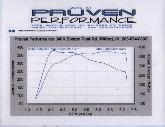

Guys the technical achievement of the dual stage flash continues to shock even myself
Here is a customer who was with the gentleman in case study # 128 who had the Buschur Stroker kit
He wanted a safe conservative reflash and the ability to turn the boost up and hit the track in his native Dubai where he is shipping this car next week along with the evo in case study # 128
His mods are
2003 Evo
Injen Intake
AMS 3" exhuast
Walbro fuel pump
HKS 272 / 272
Forge UNOS MBS
APS BOV
Dyno Flash dual stage reflash - this was the high boost level at 26 psi tapering to 20 on race fuel
IMHO amazing power with the small hot side
The way it works is he lowers his boost to 21 psi on pump gas and makes 340 whp and TQ - when he has race gas he just raises the boost

Nice numbers... too bad I didnt have the same luck today...

Nice numbers, 340WHP on pump is pretty good.
