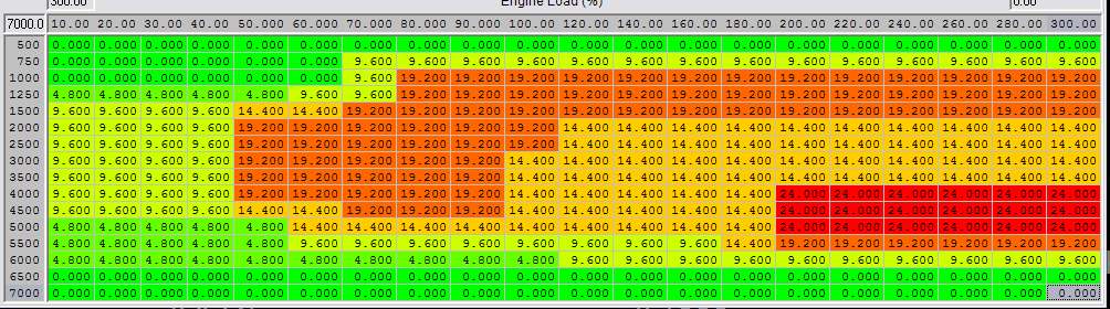

Here A Evo IX MIVEC MAP from A stock Evo IX - (I wont say which Evo IX) this is just for reference so people can see how it looks - this is represented in Ecutek softwear
Attached Thumbnails EVO IX MR DYNOFLASH RESULTS/Q&A-mivec.jpg

When I first revieved the Ecutek softwear, I strapped a car down at Buschur's Dyno and I spent a full 3 days playing with the MIVEC maps - taing it all the wy down to zero - moving it up - smothing it out - just about every which way you can to find out how it works and what it does
What I found out is that you cant really step on the MIVEC too much in the middle range or your cylinder pressures get too high and the car will start to knock
A happy medium must be found to create loads of low end tq and hold out the TQ as far to the middle of the power band as posisble

You will note that at 6500 rpms the intake cam is straight up at 0
R & D found that on stock IX and mildly modified IX adjusting the 6500 - to red line area realized zero change
Most of the gain in TQ can be found through the mid range
The factory settings arenot that far off - however they go in and out to reduce the peak TQ you can feel the effect on a bone stock IX
You can see where they massaged the mid range with a lower area of settings which has the effect to lower the TQ on areas of peak boost
The end result with my tuned MIVEC maps is to smooth out these areas and over all adjust the levels to achive smooth TQ while not over increasing cyl pressure which leads to knock

Thanks so much for posting that table! Couple of questions... What are the units of timing and engine load. Is timing in degrees? I know it says % for engine load, but why does it go all the way to 300? Will a stocker just go to 100%?

I see you've posted the EcuTek view of the stock MIVEC map ... I assume you have the same visibility/control of this map with your Techtom-based flash, right?
When you were playing with the MIVEC settings via the EcuTek software on Dave's dyno, did you see at all if you were able to spool the turbo faster by making any adjustments down low in the RPM range?
And I know exactly what you are talking about you when mention that the factory maps seem to pull a little out around the torque/boost peak. I can definitely feel that on the street (feels bad ... like power is building and building and then suddenly drops off a bit) and you can see it rather clearly on my baseline dyno here at around 3800 RPMs. I assume this is what you have smoothed out with your MIVEC tuning?
