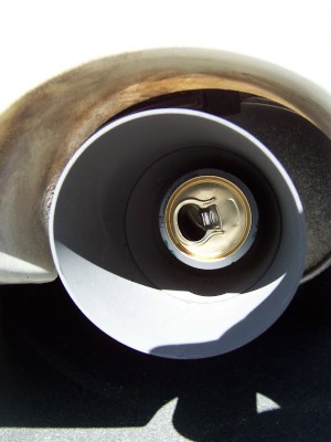

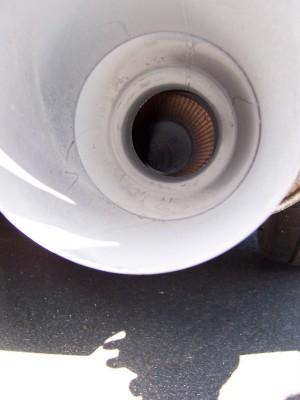

AVO = Not good at all - a tiny hole inisde a giant tip - beer can can not fit
Attached Thumbnails Beer Can test  - which 3" exhausts are really 3" ??-avo2.jpg

Obviously this avo is on race gas !
Still too small ! Beer can cant fit
Attached Thumbnails Beer Can test  - which 3" exhausts are really 3" ??-avo.jpg
