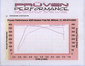

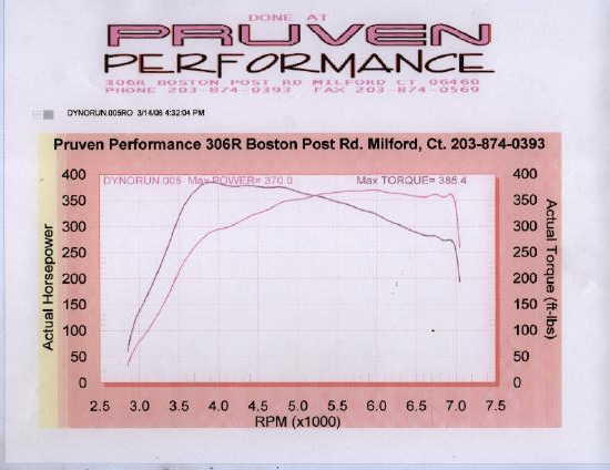

Case Study # 166 - another day of power on the dyno
Member Kmcconn9
04 Evo 8
2005 Turbo
Buschur actuator
Buschur Manifold
Buschur o2 housing
Buschur " Bullet exhuast
Buschur alcohol kit
HKS Twin Fire
272 / 280 cams
680 Injectors
Perrin Fuel rail
Buschur intake and fmic pipes
Buschur delux fmic
Walbro pump
Hallman mbc
Custom Dyno Flash
93 octane pump has
Peak boost 28 psi
The latest mods helped the spool up a lot - hitting 300 rpms sooner
BUT the 2005 turbo is maxed out
I am suggesting a IX turbo
Attached Thumbnails Case Study # 166 - another day of power on the dyno-kmcconn9.jpg

Al, what psi were you seeing at the topend 6k-7k?

93 octane pump gas
Peak boost 28 psi
ok i didnt even pick that up
BUT 28 psi on 93 ??
Old Mar 14, 2006 | 01:48 PM
EVIL_EVO_VIII's Avatar
Posts: 4,111
From: Lake Mary,FL
the car looks to be running on alky

I would love to see the IX turbo on this car and dyno again!

Me also
Keep in mind with the way this car is tuned there is another 20 easy whp on the table
I just dont like to tune agressive with such large boost on pump gas - even with the alcohol in play
I think with a IX turbo this car would be about 400 / 400
BTW - when I test drove it it was really niceto drive on the street - it has a low end TQ feel like a V8 mussel car

WOW. that is great numbers no?. al from dynoflash i have a question. can you do something like that on an 03 evo with simular mod's.
