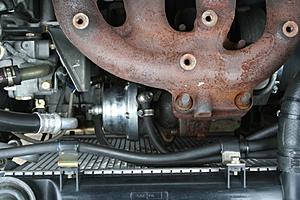

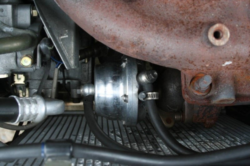

Ok guys I just got my Forge MBC today (Thanks Dynoflash!) I have included pictures of my set up below, it is a ATP GT3076R Turbo with a Tial External wastegate. Where would I hook my MBC vacume lines on the wastegate? The far passenger side nipple (left on the pictures) runs to the sensor of my Greddy E-01, that then runs to a Tee off my Bov line. The other wastegate line on the drivers side (Right side of the pictures) runs to the other end of the same Tee listed above. I want to rid me of the E-01, and I will hook up my boost gauge to my FPR vac line after this install to not interfere with my BOV line. How should I connect to the MBC to wastegate???
#2 Is this wastegate adjustable also?!?!
Thanks all

ok was warm enough to look today, I dont have a turbo nipple on my ATP turbo so I am going to proceed to connect to the BOV Tee right now..... I have not gotten a response so far....... And the fact that I have confirmed that their is NO turbo nipple......... Be back to tell you if it worked!

Yes, use the BOV/intake mani line. That's what Buschur does on all his cars anyway.

ok but according to some install guides should if be closer to the mani ie 2-3 inches away or closer to the BOV i.e. 2-3 inches away? What will cause less BOV fluctuations when the wastegate opens? thanks

I don't know anything about that aspect. I've never seen it mentioned.

as for the wastegate you can change out the spring for more boost but it can't be adjusted. The tial has different springs for different boost...
