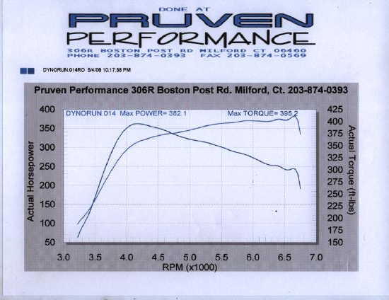

Case Study # 207 - Evo IX MADNESS
I just finished a really great running Evo IX
After yesterday's 11.5 run by Member Most Wanted I am feeling very pumped up today
We had a customer today with these mods
HKS RS Inatke
Custom fmic
HKS Exhuast
Walbro pump
Forge UNOS
HKS 272 CAM
Custom Ecutek tune by Dyno Flash
This car was insane

The 272 cam made that much of a difference? Or was it the EcuTek
Awesome power !! ALmost 400 in Torque ? !!!!

Al, that graph has that damn spike at the end again, which adds 10-15 to the max whp.
That torque is crazy, though. That had to be huge boost to have such a big torque spike that is 20-25 higher than HP, right? What octane?

Is that on pump gas or race gas?

its gotta be a mix at least 24-25 psi I'm guessing

+1 what octane? Test pipe? catless?

im almost positive he said he runs 100 octane all the time...

Correct this customer runs 100 octane pump gas all the time
His boost was slight under 24 psi peak and tapering to 19 at red line
NOTE his TQ at 6500 rpms - the IX is a TQ monster

The cam certainly helps about 10 whp
The ecutek and regulat dyno flash achive the same end result - both are great products
