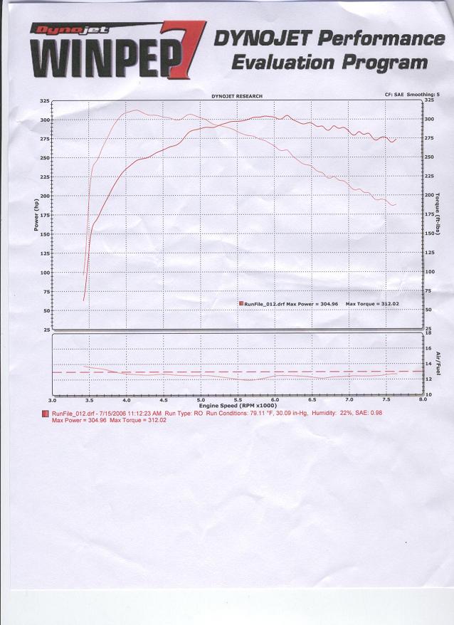

I went to the track and dyno
12.7@106 mph
Here is the graph, same horsepower and a bit less torque, but no pulling the timing. The A/F is still very lean.
304/312 corrected qith race fuel.

Send me your current map again - we need to add even more fuel, although it seems we are headed in the right direction !
PS - as we add more fuel for saftey margin now your 1/4 mile trap may actaully go down slightly as it may begin to cost you a few whp.

You may want to check the a/f reading with a 2nd wideband as if the dyno's 02 sesnor is off on its calibration your car is going to get really rich now

There was another car dynoing after me. He also has your flash and a/f were ok high 11's. (he has a 2006 that goes 12.0 in the quarter).
Any recomendation on a good wideband, since I think will save me money over the long run.

I like the AEM gauge one (the on I use in my car also)
I can get you a great price on it if you want one
With a good down pipe placement it is much more accuarate than the dyno jet wide band
