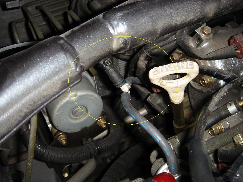

Improper Boost Gauge Install to make things worse?!
Also, after my tune I was told that the line that my boost gauge is feeding off of is potentially causing issues as well. Check out the picture. I am not sure what line this is, nor did I do the install, but would this cause any type of issue?
thats where i have my boost gauge tapped. i think that people discourage that because i think that is the line to your fpr and if it comes undone then you could run lean and blow your engine. do a boost leak test thats all i can figure out right now.
