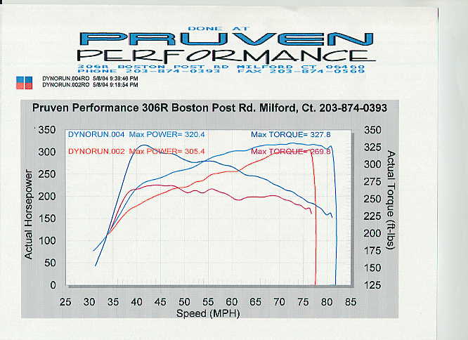

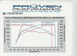

Here is a guy who showed up to represent the Evo-NY cclub at our dyno day yesterday - I gave him the offer of the Dyno Flash challenge
He had a SAFC tuned by another local tuning house on the dyno - thier numbers were almost the same as the ones that we recorded on his base line dyno pull - 305 whp (not bad) and 269 ft lbs - not too good
His dyno curve was a bit bumppy and when I road tested it he was pulling timing in the middle - 5 degress ; then 2 degress then 5 ; it was a real rough power band
After installation of the through the mail Fire Ball 3 reflash - retail $199.99 - you can see his trq jumped up almost 60 ft lbs and is a lot smoother and better feeling
His top end picked up 15 whp and his car is now tuned much more safely
His previous tune was almost at 13.0 / 1 a/f which seems to be popular with some other tuners
The results speak for themselves and we have another satisfied member of the Dyno Flash happy customer group !
Anyone who wants to take the Dyno Flash Challenge - call me any time
If we dont get your car making more power and smoother your dyno time is free and you go back to the previous tune you had before

Game over ! Dyno Flash wins every time
By the way this guy's mods had NO CAMS !!!!!!!
RMR intake - ralli art induction pipe, intercooler pipes, 3" exhuast with test pipe, walboro 255 fuel pump, HKS EVC V, super afc
IMHO - an amazing result with such few mods

another fine dyno sheet i'm sure the "other local tuner" would find some excuse as to why you picked up more hp and TONS more torque...no?
Thanks - I think ther can be no lame excuses here. Apparently when the other local tuner tuned him, they did a dyno sheet which had the same exact ft lbs number but 10 more whp. That dyno was done in colder conditions. I would say our base line on the other tuner's work is very close and very representative. Hopefully the car owner will comment here on how fast his car is now because honestly it blew me away fro a car with no cams.
It was kind of funny - when I took it for a test drive, as soon as I nailed it his exhuast muffler shot off his mid pipe. It hits very hard down low.

Originally Posted by Zeus
"More power" is very subjective...
I agree 100%. That is why i do not like making power estimates.
A guy with this level of mods can make from 285 whp to 320 whp and be tuned perfectly.
For me the main issues on tuning are repeatability, lack of ecu induced knock corection on the timing and low egts combined with a ultra smooth dyno sheet. Very often we have to compromise a lot of power left on the table to get a smooth sheet.
I will be the first to admit that this particular car was on the very high side of power for its mod list.
However - the point was to demonstrate what my $199.99 through the mail flash could do against a custom dyno tuned AFC from a reputatble tuning house.
Just for info - his final tune was de-tuned 4 whp from these levels as we felt this particular tune was too agressive for daily use.
Margin of saftey is very important.
