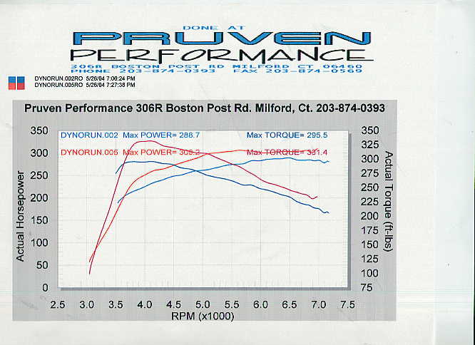

We had a guy come by today to resolve some "Dyno Flash" issues he had
ONLY problem is that he did not have a "Dyno Flash" or any flash from me
In fact - he had gone to another local shop (tri-state) - who gave him a "Dyno Flash" on his ecu
Now - this partidular customer is a very classy guy who does not want me to name any particular shops or names and I have to respect that
However - I would really like to set the record straight - I am the only source for DYNO FLASH - sure there are other reflashers - but IMHO as far as reflashing goes I have by far the most experience reflashing Evo 8's and I think that my results are unique

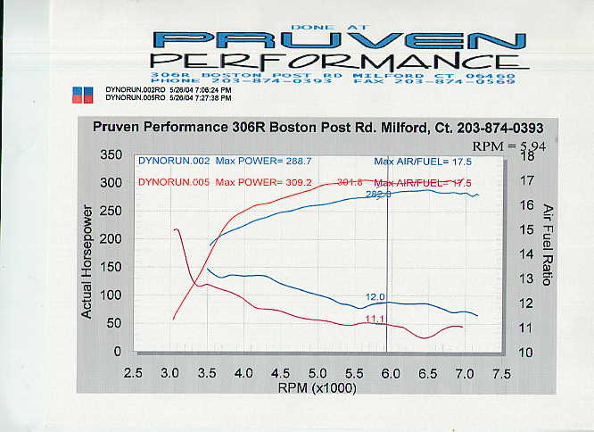

Here is what happened when he rolled in with his car - RUN #2 from the "other" shop - note danerously high a/f ratio for pump gas of 12.0 / 1 or higher and no power due to the ecu pulling mega timing as a result of the too lean a/fs
My DYNO FLASH is run # 5
Note the richer a/f ratio and yet running more power and note the massive trq gains which are the hallmark of the real Dyno Flashed ecu
This car had 264 cams, MBC, drop in filter, Walboro fuel pump and a cat back exhaust - - IMHO a down pipe would have helped him to pick up another 10 whp and a intake like the HKS RS or the like would have given at least another 10 whp
I think we got some decent numbers given the level of modifications he had
Most importantly - he came to us becuase he was having problems after he got the other tuned on the dyno "Dyno Flash" from some other shop
The car was running wonderfully after we got done
Beware of anyone claiming to sell the DYNO FLASH - its ONLY available through me
Attached Thumbnails They called it a "Dyno Flash" - WARNING - all flashes are not created equal!-vsturbo.jpg

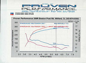

The difficult mission in reflash tuning is to run the car richer and with a greater margin of saftey while also increasing the whp and trq and running significantluy lower egts
Compare the power and a/f ratios
Attached Thumbnails They called it a "Dyno Flash" - WARNING - all flashes are not created equal!-af-s.jpg

I was impressed when I saw the chart........then I looked at the comparison of the a/f ratios........wow............very telling story. Power + margin of safety, nice work.

Is there any particular reason the tq/hp curves aren't crossing at the same RPM? (5250?)
How much detonation was he experiencing with that fuel curve?? Was it detectable with the knocklink?
Old Jun 4, 2004 | 11:13 AM
mikesevo8's Avatar
Posts: 1,078
Likes: 61
From: Ulster County, NY
Notice again the left and right sides of the sheets. The HP and TQ are not the same scale.

If I am not mistaken the left side is the HP scale (upper lines on graph) and the right side is the A/F (lower lines on scale)
The torque numbers are not shown.

Ummmmmm - I was refering to post #2
I assume MJ was also ...
Old Jun 5, 2004 | 11:19 AM
timzcat's Avatar
Posts: 2,691
It was late and somehow I missed #2 and only looked at #3 and #4.
