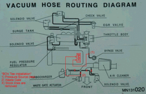

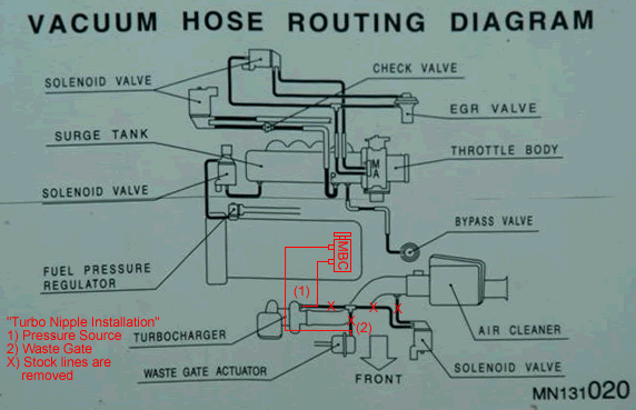

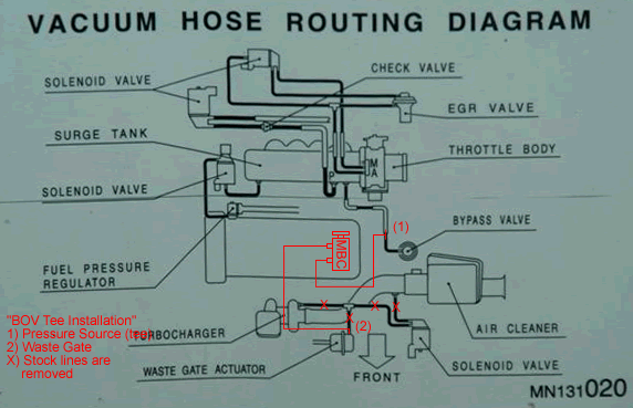

Hey, I just came across this thread and want to make sure I understand. I have a Buschur MBC and installed it based on the diagram posted earlier in this thread. Basically the pressure source is from the BOV line (see MBC2.gif, "BOV Tee Installation" diagram). What I understand Al is suggesting is to use the turbo nipple for the pressure source (see MBC1.gif, "Turbo Nipple Installation" diagram).
I hope these diagrams are helpful, I'm doing them from memory while at work. :-) Let me know if I got them right.
EDIT -- Oops, put "vacuum" where I meant "pressure".
Attached Thumbnails Hallman MBC doesn't hold boost?-mbc1.gif   Hallman MBC doesn't hold boost?-mbc2.gif
