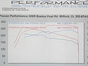

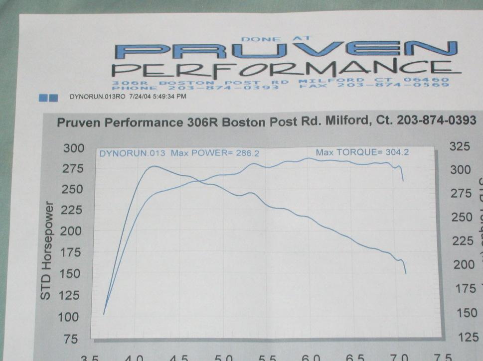

got my dyno sheets here.
Attached Thumbnails Just got my DYNOFLASH....-picture-495.jpg   Just got my DYNOFLASH....-picture-494.jpg   Just got my DYNOFLASH....-picture-493.jpg

Thanks for posting the nice dyno sheets - did you get a chance to try re-routing that boost line yet ? I am very anxious to see if my theory is correct !
