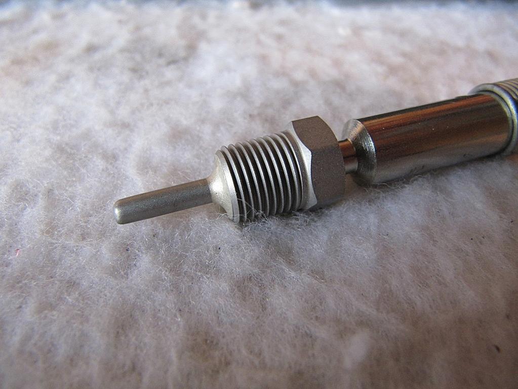

So I received my new Probe from Omega, and just wanted to follow up with this thread as I stated I would. Attached is a piture of the probe I received from Omega, all for less than $40 to my door. I even had it within two days..
You sir, have a nice probe....
This is the zeitronix probe.
Can't see the picture.
Edit: Assuming since I can't see the picture at work, can you post a picture of the probe with a ruler next to it so that I can see the exact measurements of it?
Once I get that I guess I am buying a second probe now from Omega.
