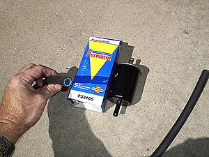

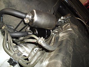

For the guys running E85, are you running anything special for a fuel filter? I know they make some nice filters like the Aeromotive filter but its like $100.
Right now I'm using the filter that came with the Bushur Double Pumper setup and added a Purolator fuel filter to the 2nd line but wasn't sure if that filter is okay to use with E85.

You can buy one from Buschur (I think they are $30)
I replaced my Buschur one with this http://www.jayracing.com/index.php?m...roducts_id=263
I like it since you can open it up clean and reuse.
Old Sep 18, 2009 | 06:34 PM
0xDEAD's Avatar
Joined: Jun 2009
Posts: 312
From: central pa
The buschur filter is not and has never been rated for E85 use (as stated by the supplier Kinsler Fuel Injection). It has however been used long enough to be determined to be "E85 safe". But to be honest, every filter I've used on E85 has tested out to be "E85 safe". That includes stock DSM fuel filters, stock evo filters, Summit fuel filters, cellulose filters, and the Kinsler filter.
