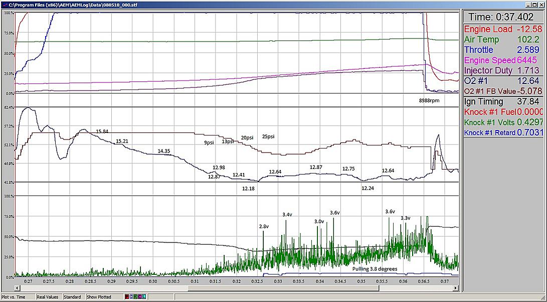

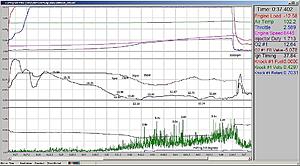

So I have made the switch to e85, the VDR has me at about 620hp/433ft. I am currently in the process of turning up the boost, right now I am at 25psi, and I started with some pretty rich AFR's and the car pulled good and clean. Once I turned the boost up to 25psi, the car really did not like the rich AFR's anymore. So I have been leaning out the car to try to get the engine noise down. There are a lot of people saying that the AFR's need to be in the 12.5-13.0 range.
So here is what I am shooting for.
Spool Up - 12.8-12.9
Peek Torque - 12.7-12.9
Peek RPM - 12.4-12.6
So on my quest to get to those numbers I am seeing some very strange stuff showing up as knock. I was wondering if anyone has any advice on this.
Do you have a good COP setup?
Have you tried tighter plug gap?
AFR's should be good, assuming your W/B is correct?
I'm guessing ignition...

I have a COP, AEM TwinFire.
I was running BPR7ES gapped at .020.
I switched to BR8ES gapped at .020. Now I have a massive missfire around 8400 rpm, so I will tighten up the gap a little more. I also go the AFR to be pretty consistant.
Peek Boost = 12.47
Peek Torque = 12.65
Peek RPM = 12.50
So it is pretty much 12.50 across the board. I am not sure why it would missfire up top except gap. It was only at 15 degrees of timing. Is it possible to have to little timing?
So my car goes from
Peek Boost = 5*
Peed RPM = 15.5*
Old May 9, 2010 | 01:37 PM
Jim in Tucson's Avatar
Joined: Oct 2006
Posts: 1,480
From: Tucson, Arizona, USA
I'd suggest dialing back the peak trq timing a bit.
Your red-line timing should be OK, but the peak trq timing might be a little high. If you are getting some knock at trq peak it can easily cascade into an even bigger event.
I think you will find that zero timing at peak trq is common on E85, but each car is different.
I think it is much safer to pull a bunch of timing and then add it back in small increments. Work the timing up rather than down, if that makes sense.

Originally Posted by tscompusa
btw what you said makes absolutely no sense at all. turning the boost up requires more fuel in return the afr will go leaner by default. It should have ran better regardless. The cars probably pulling timing without you realizing it. read the bottom stuff mentioned about timing.
I will re explain.
At 10-22psi, my base tune was at 11.8-12.2 afr's. When I turned the boost up to 25psi, the car no longer liked 11.2-12.2 afr's.
This could have been plugs, afr's, or timing. This could have also been related to me having a little q16 left in the tank when I first made the switch to q16. I just finised tuning the car at about 700whp on q16. I was tired of paying 15 bucks a gallon for Q so I made the switch to E85.
Now that I am 100% sure that there is no Q16 in the car, the E85 could be telling me what it wants.
Also I am on an AEM EMS, and in my log files I can see when it pulls timing related to knock.
Here is a screen shot of a pull I did recently.

where is the timing graph on that log? i dont see it. be careful, e85 isnt like q16. knock your peak torque/load area down to 1* and go from there. once you get close to where mbt is you will gain crap tons of torque. dont push it past 20* uptop with e85.

Awesome, good info.
The next big steps for me are gapping down my BR8ES to .018.
Pull even more timing out of my map. I am going to pull it all the way down to 1* and have it ramp to about 15*
