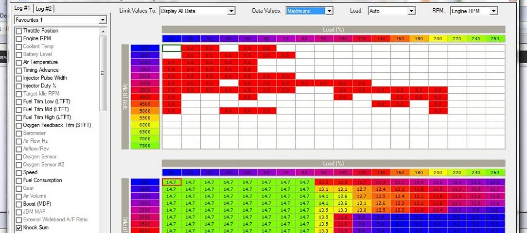

Alright, Fast_Freddie .. Thanks for the advice.
Everyone who gave input .. Thank you.
Scaled injectors to 496. (750 * .66).
Added +1 degree in 120 - 200 for 3500rpm's to 7500rpms.
Look at my map after a 3rd gear WOT run.
She feels ALIVE!!!!
Also no more P0134
Old Nov 20, 2010 | 05:24 PM
Sorry Bro, I dont. I only have the AFR, Boost & timing profiles
BTW, Looks like youre on your way on getting all the trims in the right place.
