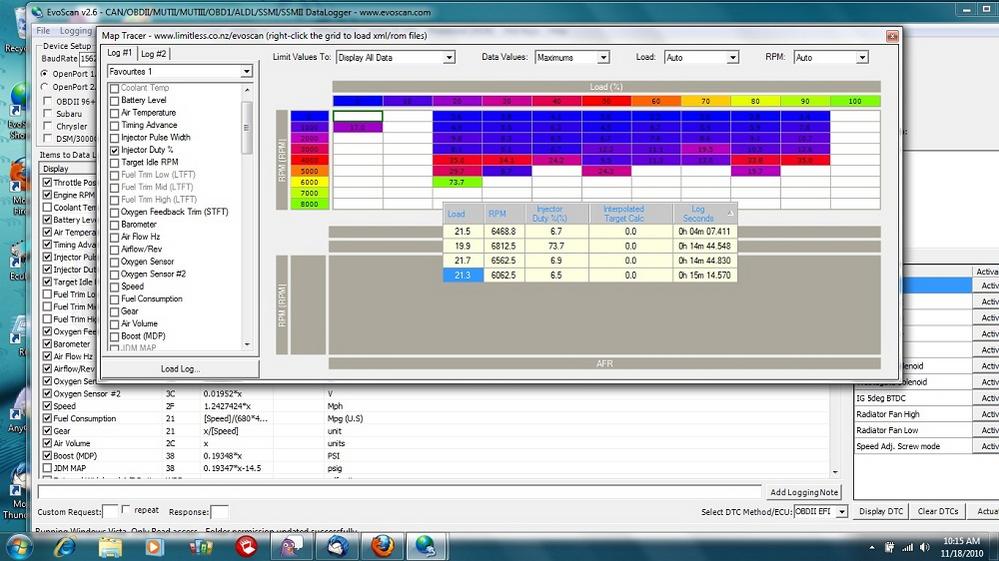

So I started playing with my injector scaling with E85 and it's now at 636cc scaling from a 680cc scale and after another 60 miles of driving no more P0134 yay!
No knock either .. yay!
But oddest thing .. even at WOT I'm not getting to 80% IDC ..
I was told this has 750cc injectors .. but if I'm not hitting 80% IDC with E85 on a 636cc scale .. then I must have bigger injectors right?
I bought this car with all of its mods already done.
It's got cams and gear, that's physically apparent from the side and the V8'ish lop she has sitting idle which would also explain the ghost knocks in evoscan right?

And Kevin based off his log...his maps only go to 100 load...and he's only hitting 20 load at 6500 rpm? Right?

Right now this is where I'm at with 504 scale.
In the 200 load I got 2 counts of knock,
I'm at 93% IDC
This was from doing a 3rd gear WOT run.
Right now she's feeling like alot more fun.
She takes off from the line much quicker and my throttle response
seems better.
I've read MrFreds post about his E85 dealings and saying it felt "soft".
My experience is .. It's made my Evo harder than a 20 year old on viagra.
Going to try 496cc scale and see if that kills the 200 load knock .. if not ..
Timing pulling it is.
Thanks for pointing me in the right direction.
