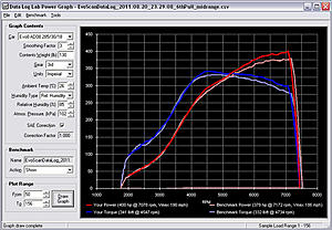

Here's a tuned comparison of before and after E85. However, my tank has about 2 gallons 93oct in it mixed with 5 gallons E85, so there's still more to be had once I go through a couple more tanks.

yea on the BBK Full you have MUCH more in it
Oh...I'm keeping it at the same 24psi still. I wanna see how much one change can do first. My timing at redline is only 15* at the moment. I increased it to 16, but it lost power, so I figured I was at MBT for the mixture I currently have.

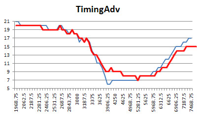

Here's a timing graph comparing before and after (red is before, blue is on ethanol). Weird how ethanol wanted less timing at peak torque. Keep in mind that my mixture is roughly only 70% E85 due to leftover 93oct when I filled up.

Yea less timing at peak torque is normal for ethanol.
You will for sure have much more 5.5K+ though.

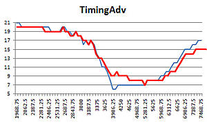

Jim, I really appreciate your help with this What do you think about this now:
I'm kinda uncertain about peak torque. Usually my peak torque is at 4200rpms. Does timing look ok there to you?

24* might be a bit much out the top.
