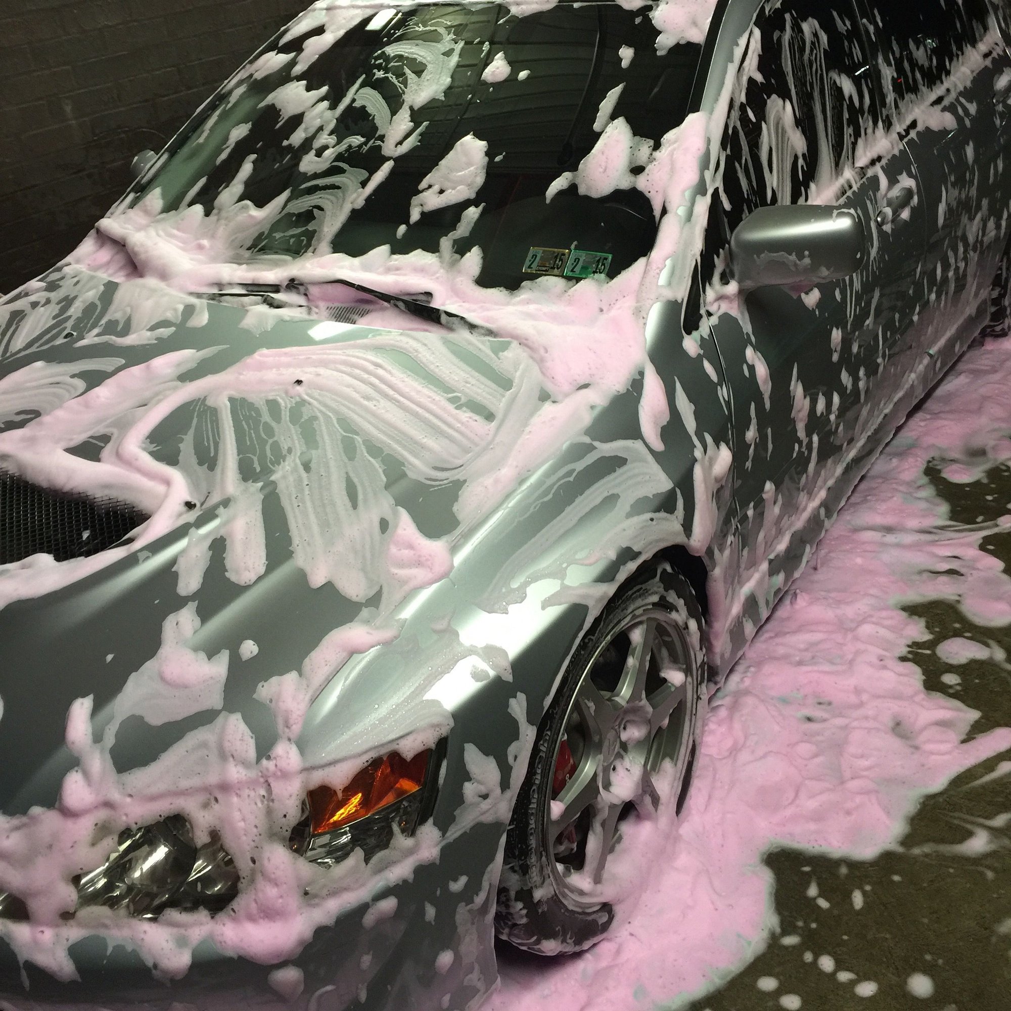

Heres the last of pictures I took. I put new fuel filters on, cleaned some debri from the fuel tank, and modified both the fuel pumps relief valves. After all this, I was able to tune the car and keep the AFR under control. I also replaced the FPR to be safe.
Rich picked the car up tonight with his brother, and before they took it I put brad penn 20w50 in it as well with an amsoil oil filter.
Rich's brother seemed to under estimate how quick the evo really was when they are up into the 600whp territory. I told him to do a couple pulls on the way home, and as soon as he did he was very surprised.
We replaced the cheap worm clamps with tbolts. Shouldn't have anymore lower pipes coming off anymore.
Not sure If I posted a before engine bay shot, but lets just say its a night and day difference now. I have cleaned up atleast 80% better then it was when I received the car.
I will share the graph and other info later on. Just have to get it all together. The car made great power though.
The stainless housing fp black really is quite different then the twin scroll. It made power extremely easy. 28psi put us over 600whp.
