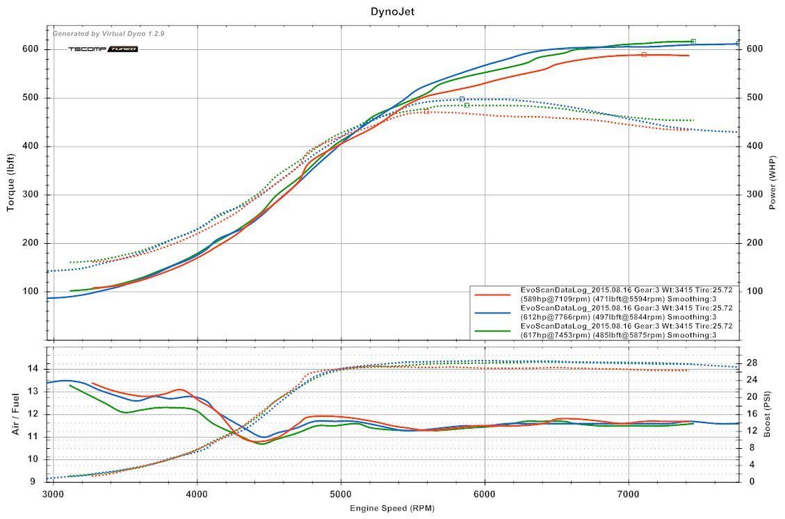

Heres the final outcome of this car then after tuning. https://www.evolutionm.net/forums/ev...e85-28psi.html
For those who dont want to click links heres what it ended up doing:
