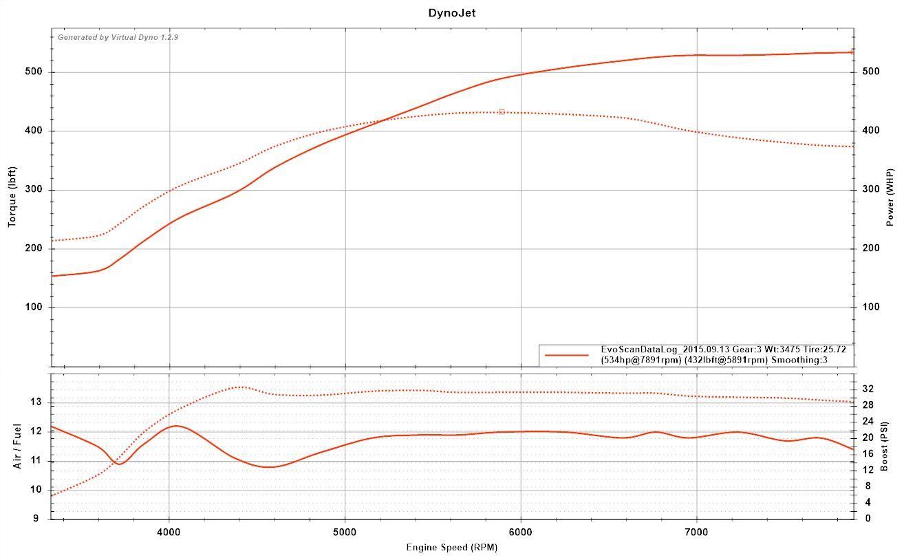

Where would you consider my peak torque on this pull? That was when I was still working out rich spots after installing my double pumper so I took care of that to stay mid to high 11s but this was just the first log I found from what I know was a flat road when I was running more boost.

That looks pretty good. Peak torque would be right where the graph says it, and itholds it for several hundred rpms.

10.5 MHI. I think I ended up picking up boost a little earlier and holding it a little longer even. When I get the tune done for holding 400 torque as long as possible I'll post a graph in the dyno section. I think I can add a little timing in the 4k area to pick up boost earlier. In 4th through 6th gear I can build boost so much faster but in lower gears I would like a little quicker spool. I had lower WGDC in 4th but still built 38 psi just past 4k before when I was afraid I fried my clutch. I dropped the boost and am up to around 350 tq now in 3rd with no slipping.
