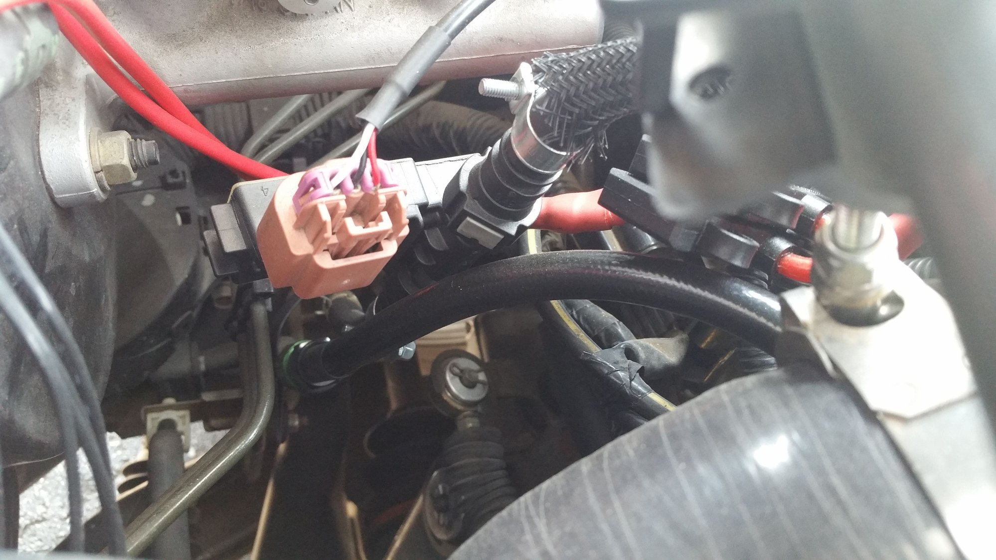

Here's a picture of the adaptor I used. This is probably the simplest option.

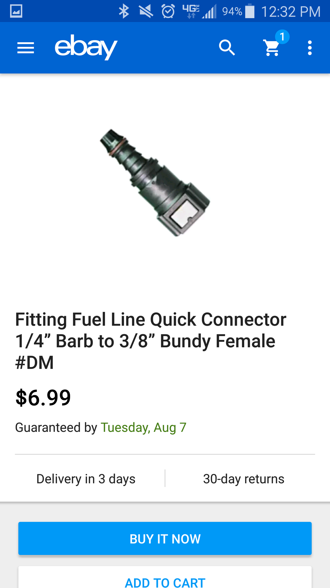

I think I bought 2 of these to use.

Wow, thanks guys, looks like problem solved. I'll go with 2006EvoIXer's solution first.
