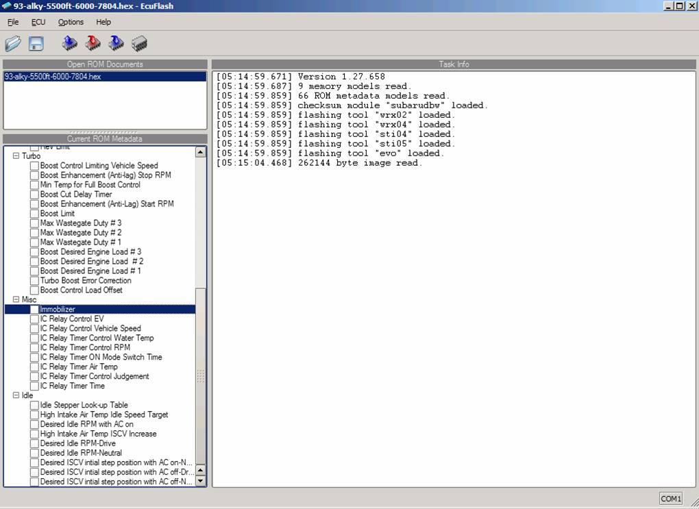

With your ROM open in EcuFlash, go down to the Misc section. Immobilizer is the first selection. Click on it to pop up the box showing your code. Click Edit>Copy. Then, open whatever other ROM you have, go to the same spot, open the Immobilizier and hit Edit>Paste. This will set the Immobilizer code to the same as the one from your car. I wasn't able to get the code to change by using (=) to set it directly, so I did copy/paste, which worked.
I used this on the Stock 05 ROM that can be found on the website, because I wanted a stock map and valet map. I took my modified-immobilizer Stock 05 ROM and changed the rev limiters for valet mode. I have not yet loaded these maps, though, because I wanted to make sure this was the right way to do it.

Do you have version 1.26 or 1.27? I have the option under Misc with the 1.27 version. It's not based on the MAP - it's based on what parameters can be seen. Any map I look at has this selection.

I was referring to when you said you downloaded several maps and didn't see it. I'm saying that it doesn't matter how many maps you download - the Immobilizer is on every ROM, but you're not seeing it due to the software. When you downloaded 1.27 and installed it, did you also add the extra ROMMETADATA files that MalibuJack posted? That's my only guess...

Originally Posted by elhalisf
Access level wasn't it It defaults to beginner which will not show the immobilizer map and a host of others.
