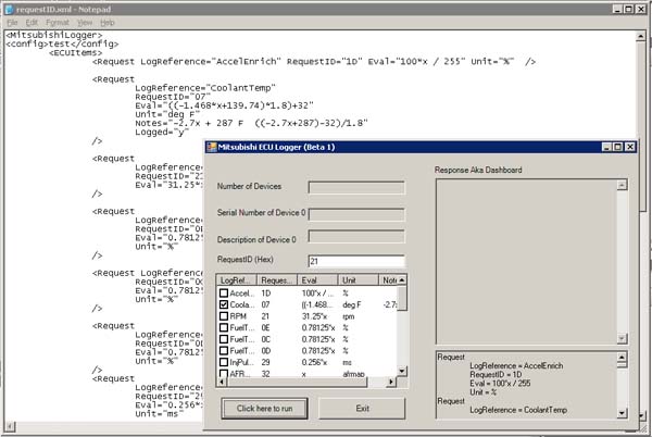

A teaser...
So far the code works, just resolving some issues, I'm currently in the process of working out loading ECU data and its associated XML data for different roms to retrieve Injector Scale, Latency, Load Axis, RPM axis, and ignition map..
Map-Tracing in its most rudimentary form works except in closed loop where its off, this is of course pretty typical of how closed loop fuel control works.. I'm trying to locate an actuator requestID that turns off closed loop operation to allow for tracing and logging open loop values at cruise and idle.. It should help tuning IMMENSELY..
Attached Thumbnails Mitsubishi Logger proof of concept code WORKS!-msbetapreview2.jpg   Mitsubishi Logger proof of concept code WORKS!-mlbetapreview3.jpg
