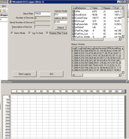

Just a quick update...
New Baudrate feature added, I will add a checkbox for "Bez Acceleration" so it fills the right speed automatically, but it will support different logging baud rates if their modified differently.. In the future, this value will be extracted from the ROM itself, along with the axis data, injector scale and latency, etc..
Made some other changes that I don't recall at the moment besides fully functional math with embedded variables for all of the logreference values in the table EVEN previously calculated custom requests..
Attached Thumbnails Mitsubishi Logger proof of concept code WORKS!-mlbetapreview4.jpg
