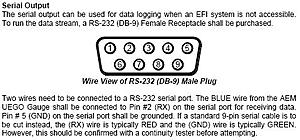

LoL!!
blue goes to 2, black to 5...black to the same ground as the gauge
get a 9 pin rs-232 end from radio shack, the pins are numbered on the face

Originally Posted by Liqquid
LoL!!
+1, cost is about $5 to make! (if you have the soldering iron)

AEM Serial Pic
Here's the section of the manual that describes what to do.
