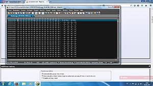

Originally Posted by evoscan
oh, that is just what you see when you open up the definition text xml file EMKS11.xml
When i open my downloaded file i see strange symbols.
thanks

RST_89's Avatar
Joined: May 2014
Posts: 17
From: Austria
you forgot what I said a few posts back... you have to press CTRL+H have a read on the last page.
yes i know but it makes no different. same strange tables!
thanks

Old Jun 17, 2014 | 04:26 AM
  #1545
evoscan's Avatar
Silver Sponsor
iTrader: (-1)
Joined: Apr 2010
Posts: 886
Likes: 21
From: nz
thats not strange.. that looks fantastic..
now follow the 2nd instruction I said in a few posts back..
after pressing Ctrl+H in ultraedit, now press CTRL+G and goto the location
0xf52 for evo7/8/9/airtrek
0x1021a for Evo 5/6
0x1fefa (for vr4/galant/legnums/mirage)
0x2fefa (for vr4/galant/legnums/mirage)
and take a screenshot of each for us to look at.
