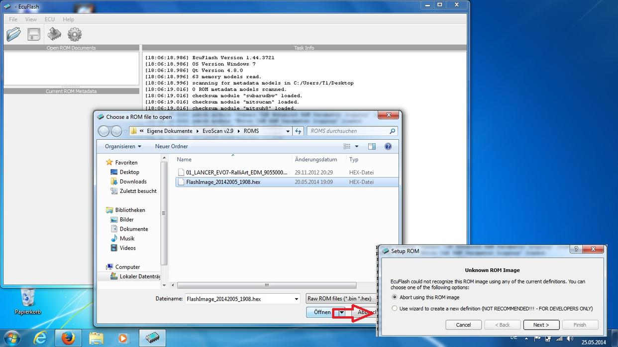

can not open the file
Have a little busy myself today with the Evoscan software. Connection and fault memory read out. Everything worked well.
I've already uploaded the (*.hex file) with evo scan software.
But just can not open the file (*.hex) with the ECU flash software. Can the tolls still be unlocked? i have no key! or how I need a licence?
Picture in the note.
thank you and sorry for my english
open the hex file with ultraedit or notepad++ and go to the rom id hex location and you can see what the RomID is, you can download the definition from the Mitsubishi database in my signature below.
