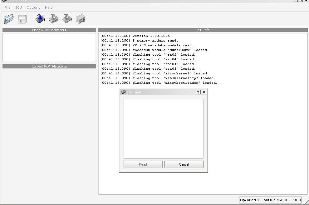

Originally Posted by leocyd
here is a screenshot to show the problem
i am having the exact same problem as above (cant read ecu... the button is greyed out). i could not find a solution by searching. i REALLY need help with this. i never had this problem with my last IX, but i totalled it and now i have a new IX and i need to download the ROM and immobilizer and i cant....
thanks for your help.
