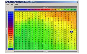

Here is my alchy map. I have spray coming on at 15psi maxing out at 20psi. My boost is spiking to 26psi and holds 24psi through most of the midrange. I have zero knock and I am seeing a load as high as 255. My afr is tuned for 11:1.
This map took me 3 days to build. It basically a drag race map with 2* less than what I could run before I would see a little knock. I believe it will be safe in all weather conditions. The best part is turning down the boost makes the same map safe for road racing.
